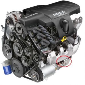

Where can I find the starter because If the battery dont work I want to give it a tap to see if she will start.

Here is where the sarter is located on a 3800 engine

Thanks for all the help...it was the battery I guess that 12yr old batt was finally a goner!!!! Tadd thanks a ton for that pick I will keep it for future use.
