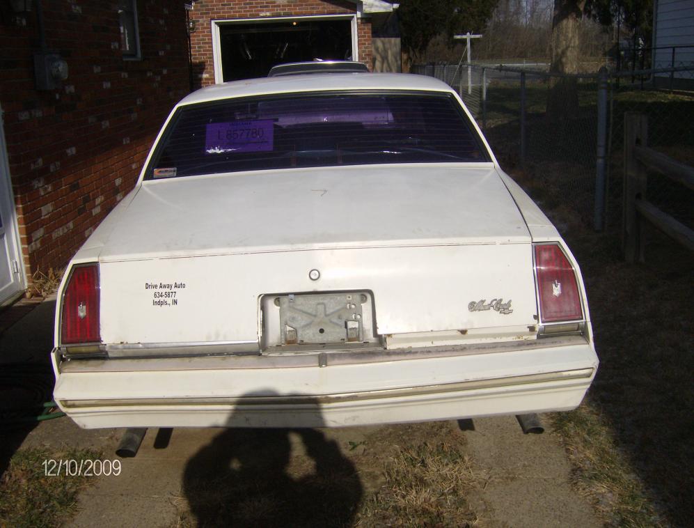

did a numbers check before i bought it.its a tru ss but i think at some point it got rear ended that would explain the sc monte trunk deck and bumper but i'm lovin the fiberglass hood its cracked at the closer think i'll repair it and just put hood pins on it instead of latch
