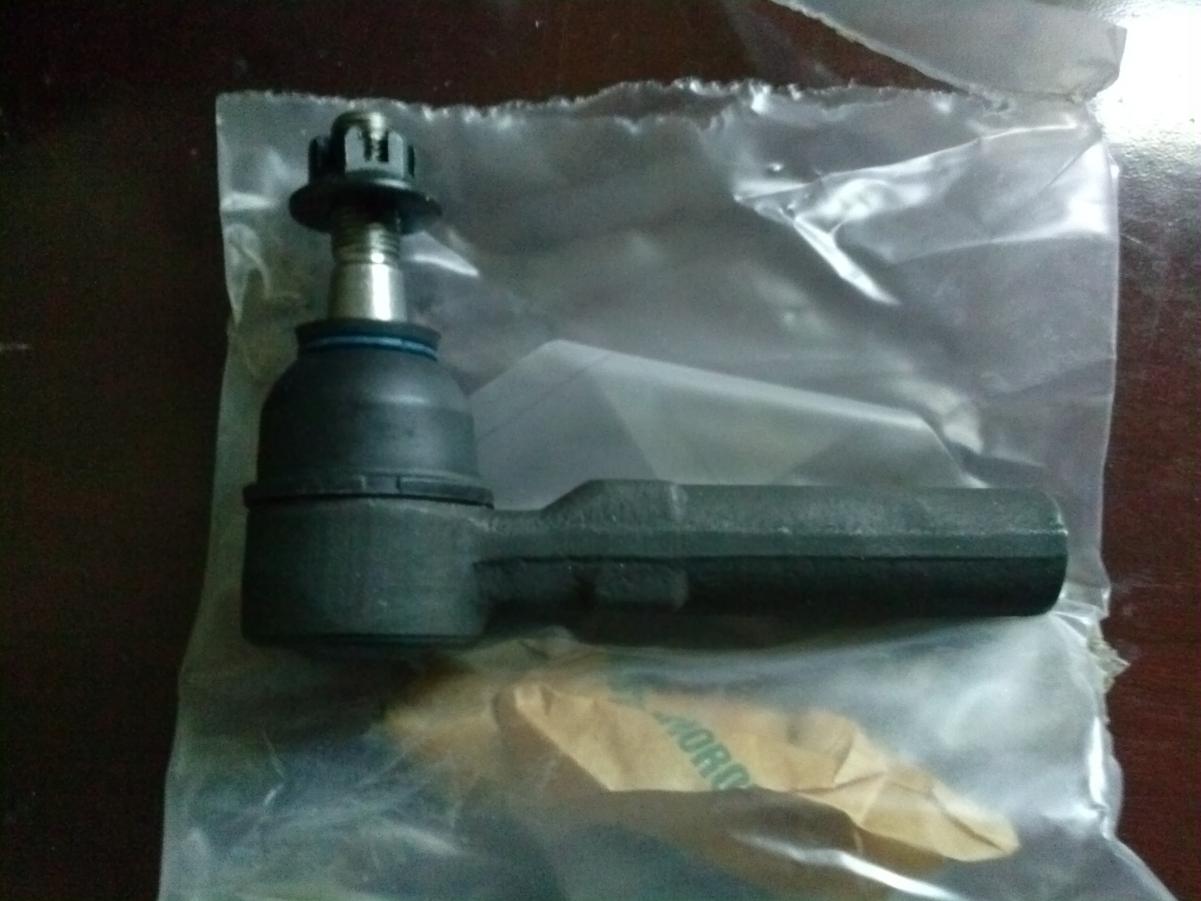

Do I have the right part? only the ends were supposed to be loose
Old Mar 21, 2013 | 11:05 PM
That is an outer tie rod... I assume if the parts store said it was right for your car, it's the right one. But without comparing it to the original one, no way of knowing if it's the same length (and I assume equal length hopefully translates to equal thread count, but you can confirm the thread count if you leave the torque nut on the inner tie rod and it takes the same amount of turns to seat the new tie rod as it took removing the old).
