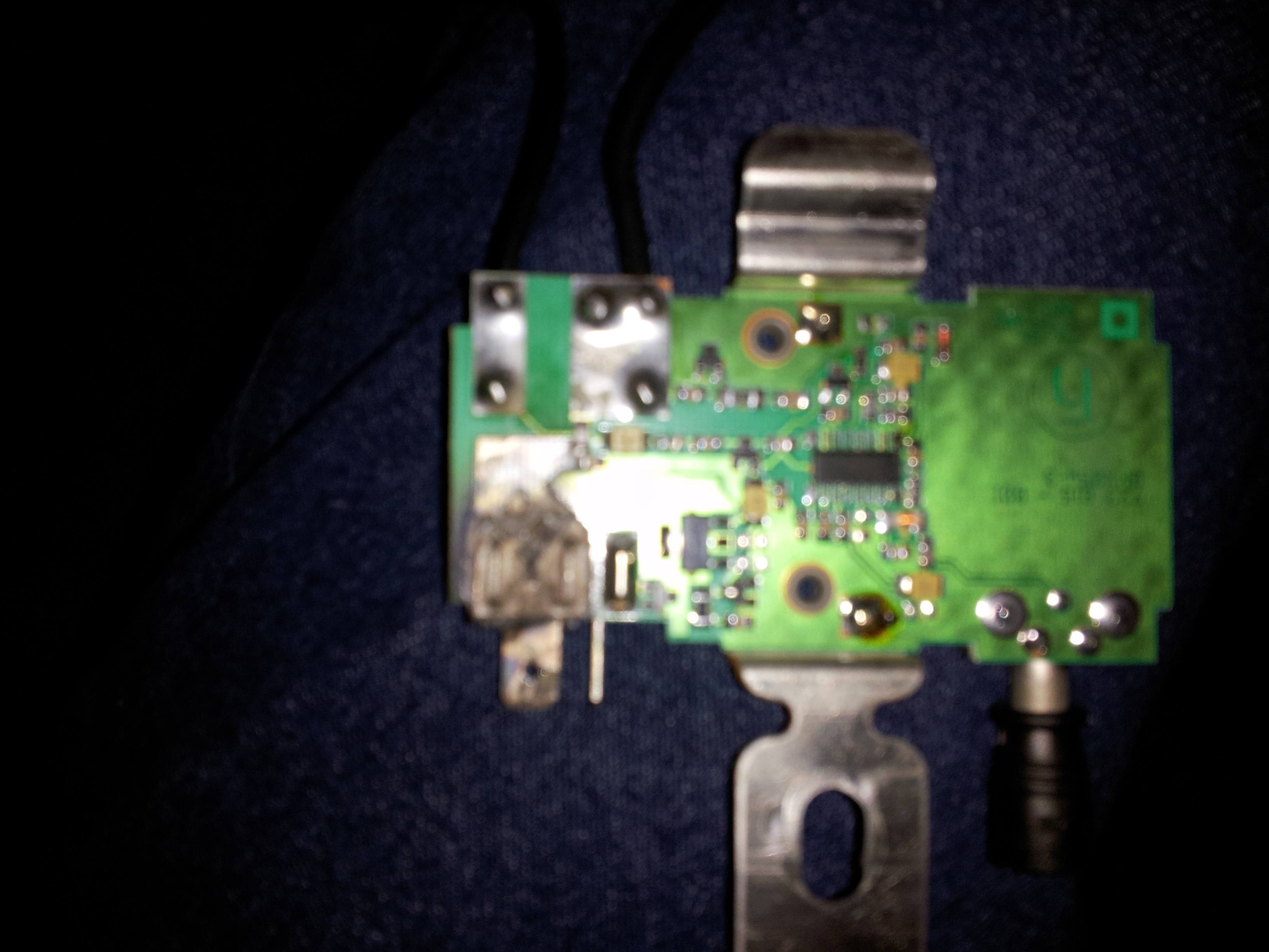

Success, watched the video about taking out the back seat and the rest was really pretty easy. I'll see if I can post a picture of the fried module

Here is the bad module, you can see on the plug side where something shorted out.

Old Dec 20, 2015 | 02:05 PM
DANG! Yeah, that is pretty toasted!!

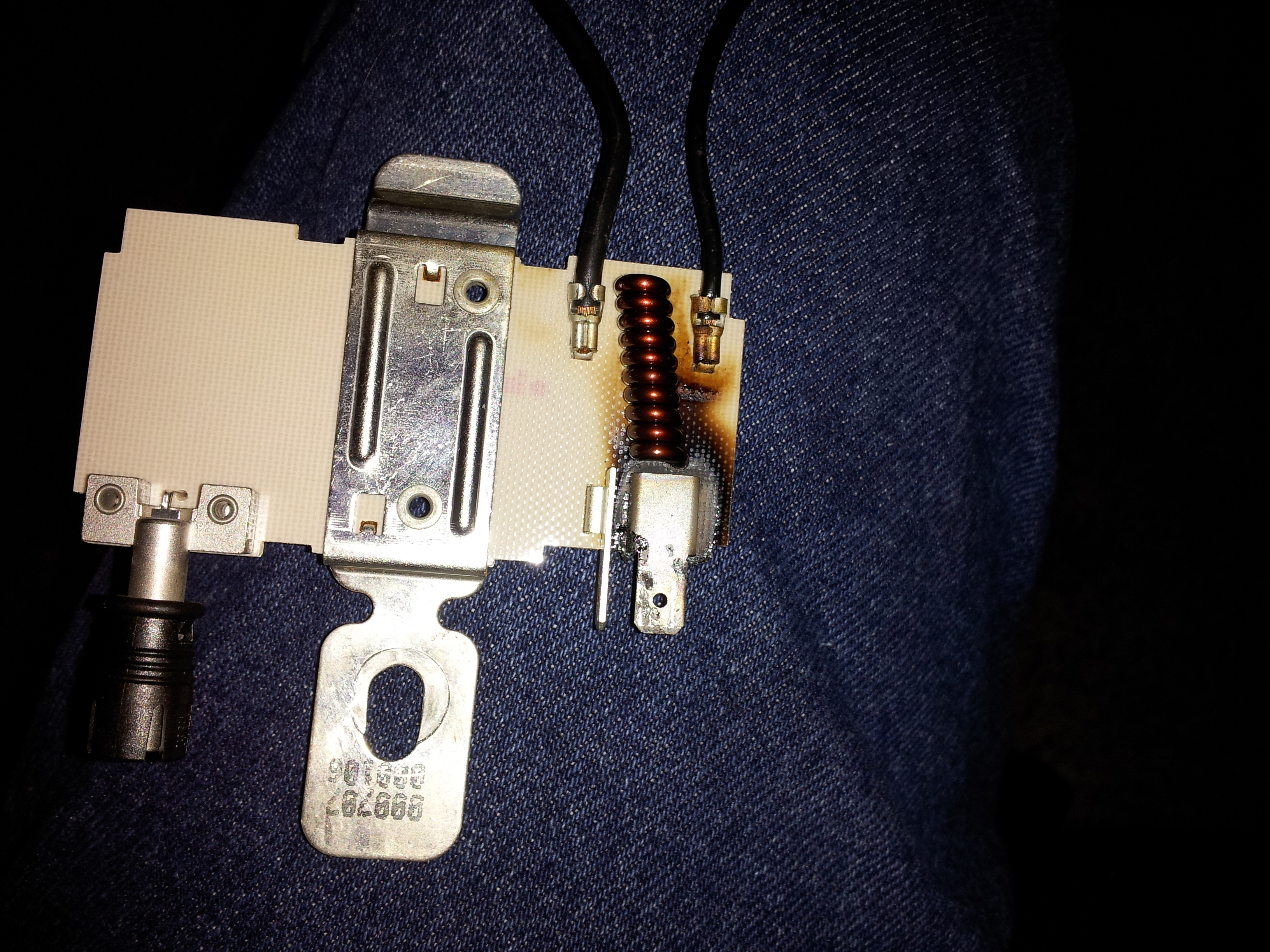

[IMG][/IMG]This is what it looks like inside front and back, the small board is broke also. Never would've thought that was in there.
