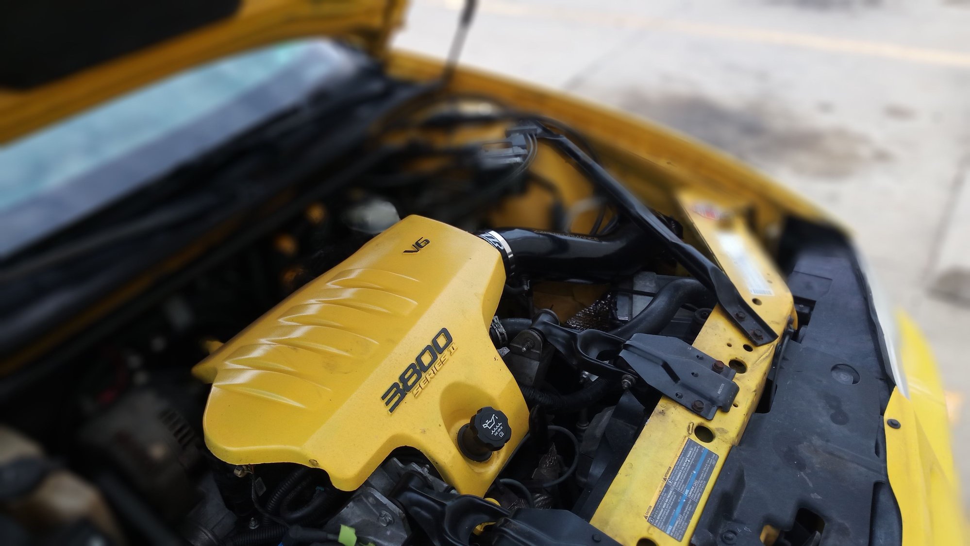

I know this is a few months old. But do you have to worry about heavy rain with a fenderwell intake?

While the fenderwell isnt really sealed, it's also not directly open to rain coming in either (assuming its intact and not gashed open from tire damage or something). Getting small amounts of indirect splashing on it isnt a big deal.
The concern with the FWI in terms of rain is more in terms of driving through water so deep that it starts sucking actual standing water from the ground.
Its hard to tell from your pic - but if the filter is on the end of that pipe sticking straight into the fender, then it's not appreciably lower than stock would be. Youd have to be in water up to the headlight to get the filter in it.
I've just seen all kinds of fenderwell termination points - some people put a 45 or 90 on the end and stick the filter pointing down, and I've also seen people with the flex duct run the filter all the way to the bottom of the plastic fenderwell floor. In either of those cases you're greatly reducing how deep of water you can drive into before destroying the engine.
It dont even need to be submerged either.. I just recently had a problem (made a post about it) where I got hydrolocked from sucking water in that was splashing high enough.
