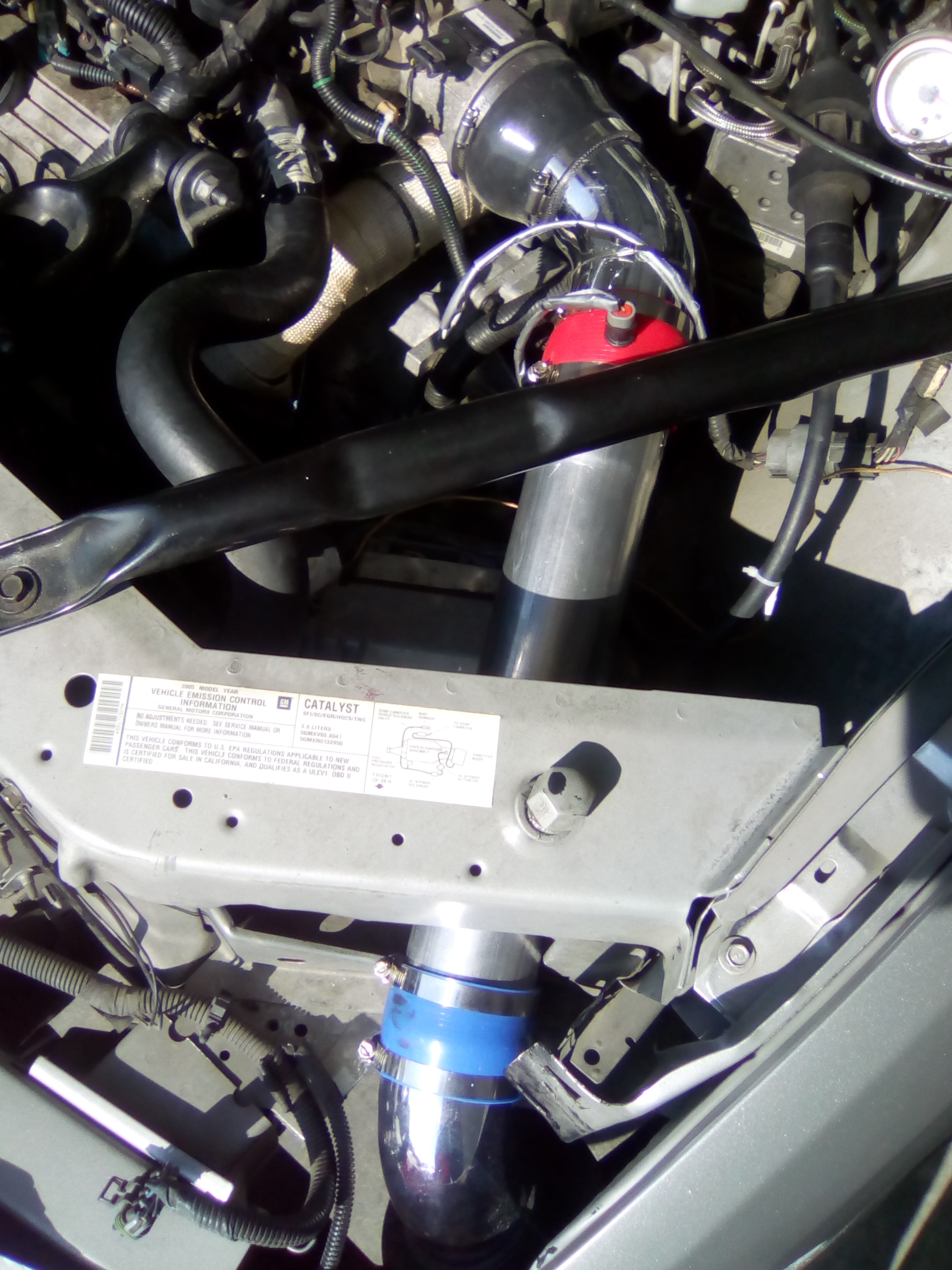

Im gonna go take a picture of mine so you can see what you could possibly build yourself for about 50 dollars..

Attachment 19347
Its simply 1 60* elbow, 1 90* elbow, 1 18" straight piece, and couplers..
You would need 2 more couplers to add the MAF into it somewhere but its just as simple AND you get the "I did it myself" credit.. Add the filter into that of course..

The whole "adding the MAF to the intake line" is WAY more intimidating that it seems.. Your MAF is 3.5" iirc.. You just need two couplers that are 3.5" into whatever size pipe you get.. Then the intake temp sensor can be placed in one of the couplers so you dont need to drill into the intake piping..
