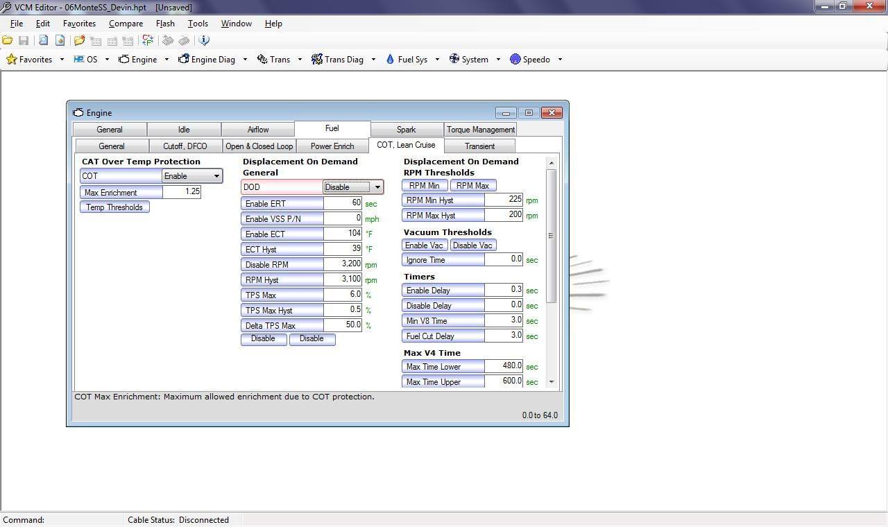

I found a guy local who will diable the DoD feature for $150. Does this seem like a good deal? He said this should eliminate the burning oil when the cylinders drop? Any possible downsides to having this disabled?
Thanks
Old Feb 20, 2018 | 01:56 PM
Where are you located, and how will he disable it?
If you don't want to answer where you live, just let me know if it's close to my location or not. I can hook you up a little cheaper, and do a little more. But if he's using HPtuners to diable it, $150 is a good deal, since it costs him $100 just to hook up to your car.
If he's tuning it out, you MIGHT notice a change in your MPGs, some people report better MPGs on the highway, some report 1-2 mpg lower. Shouldn't harm anything by tuning it out, I just really hope this is the source of your oil leak and it's not a random rear main seal or something that just doesn't show when it sits.

Unfortunately I am not near your location, he runs a tuning shop and he said he can disable it through the tune. I am not quite sure what tune he uses. I am not too concerned with the gas mileage, my jeep gets about 8 haha. I sure hope it isnt the rear main, those are pricey. Fingers crossed! From what I've been reading it sounds like this could be the culprit, I just want it fixed because it is my daily driver

I'd go for it. If he runs a tuning shop you should see if he can give you anything else tune wise for the cost. But it is really easy to remove it.
