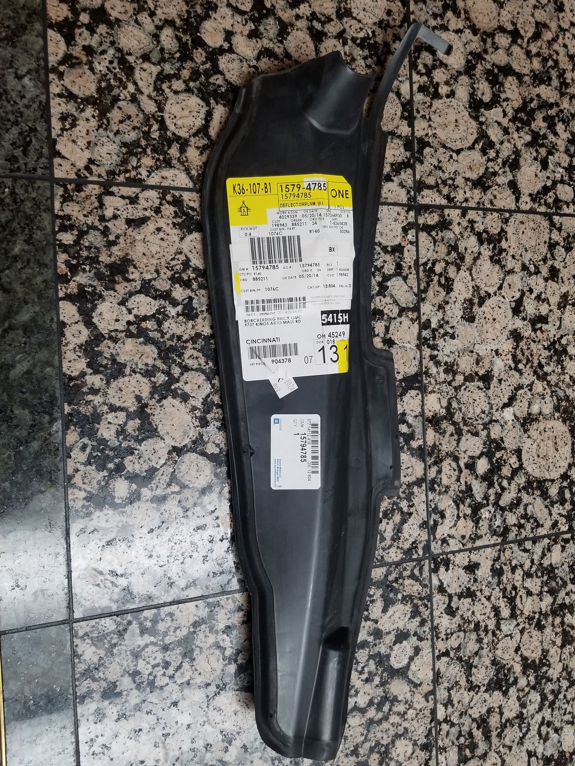

The PDF was a result of issues from PhotoBucket changing their terms of service. The pics were all borrow from a Grand Prix site, but everything mentioned is the same with a Grand Prix/Impala/Monte. I did this mod on both my Monte and my ex-wife's Impala. It is a 10 minute job, what needs "modified" is very obvious when you take the cowl cover off (a piece of plastic that hangs down). As for the pics being blurry, not sure what to say about that, they all appear clear for me both in the thread and the PDF. The clarity may be a monitor and/or a printer issue. Since no one here is the original owner of the pics, not sure they can be improved.
The piece that is added is for a newer W-body car (so it was not designed for the 00-05 Monte, but came from a car like a 06-07 Monte).
My guess, the glass shop won't want anything to do with this (you can always ask). Even though they may have to remove the cowl coverings, they should not be working with the water deflector. And even if they are, since GM has no bulletin about this fix, they are most likely not going to want to do anything that involves modifying the car (even though this is a solid and reliable fix). As for water leaks, you may want clarification on that warranty. My guess is that it will only cover leaks related to the windshield itself (that the sealant/adhesive they use to mount the new windshield will not leak). This won't cover failure of original parts that are on the car.

Actually needed this and great wright up, but after exhausting all search options this part is almost unavailable. If it can be found it is upwards of 65$ plus shipping.
I found 1 at a Chevy dealership in Canada for 65+35$ shipping....

If the part is no longer available at the dealer, it was used on multiple W-Bodies over the years. If you have a junk yard near you, look for the 06+ Impala, Grand Prix, Monte and possibly a few other cars.

I happen to have one I would sell. Picked it up years ago, never ended up needing it. The Monte lives under a carport / car cover, never had a leaky interior. But then with that being said, Maniac mentions one may be able to scavenge this part from a auto wrecking / pic a part type place. I would ask $120 for it, this includes shipping in the continental U.S..

Holy smokes guys and possible ladies. This part is not available. I have read this post pretty extensively and tried searches using the different vehicles mentioned. Coming up zero No Stock. Can someone give me a list of W body cars that I can look for in the wreckers ? My car is a 2001 Monte Carlo LS. Want to fix my leak . Thanks Herman
