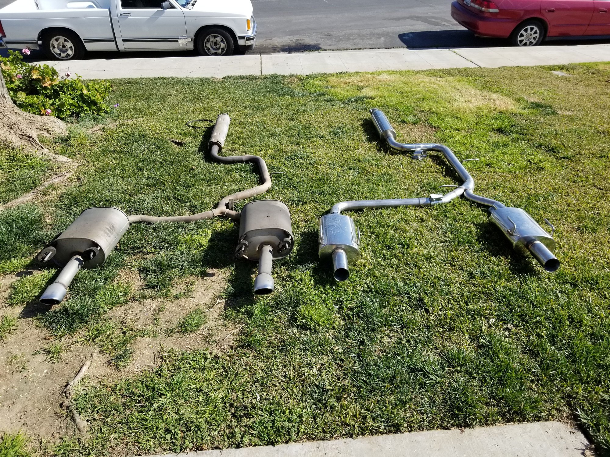

I also have a 2005 Tony Stewart. I put on the zzp 2.5 exhaust system on it. Stock downpipe (cat). I didn't notice and extra power. I put a zzp stage 2 on my other car and noticed a difference. I believe the zzp stage 2 and the zzp exhaust are close to the same price. I could be wrong.
Zzp flashed my computer with the stage 2 and I ran it like that on 91 for about 5000 miles and no problems. After 5k I put more zzp mods. I would not worry about them flashing your computer I didn't have any issues. The pictures are of the zzp and stock exhaust. I'll try to post the before and after video on my coworkers youtube page. The install was quick and easy. No need to pay anyone to install it.

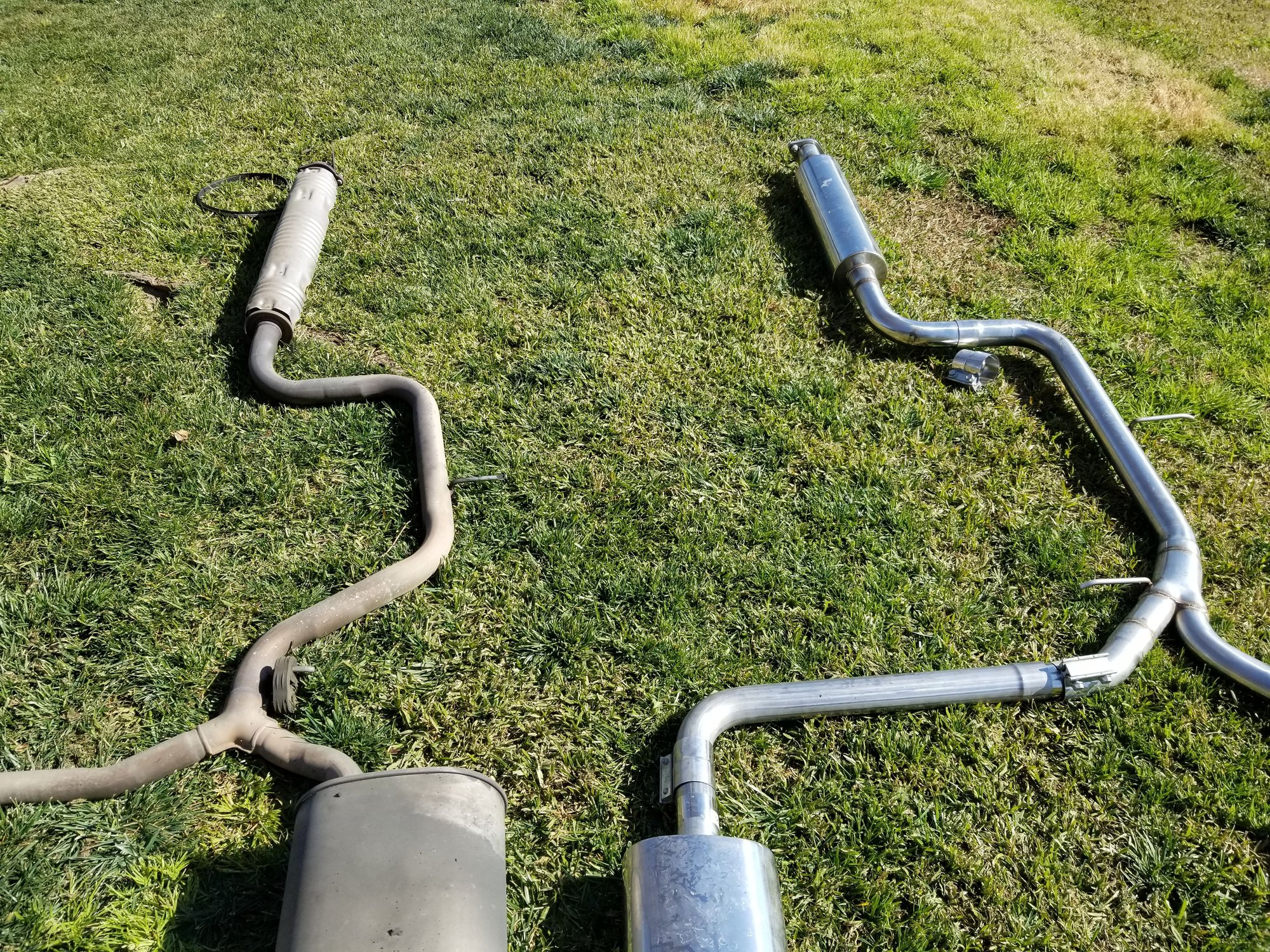

There is a section where the exhaust is crushed down by the factory, a bad stricture to the exhaust from what I heard.
There are only 2 places of real concern the U bend by the cat (not sure if 6th gen montes have those, but the stage 1 kit addresses that), and then the downpipe. Nothing in the catback is crushed down enough to be of concern at stockish powe levels.
