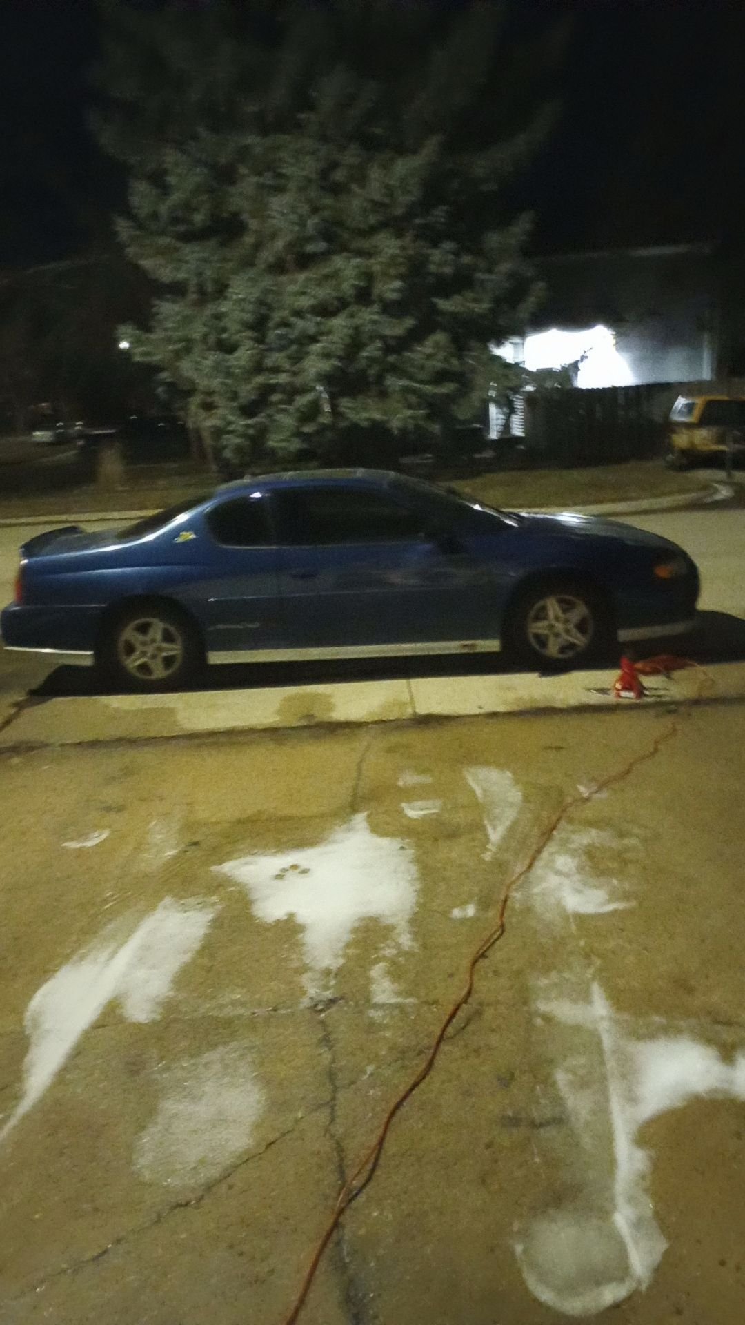

I'm trying to put together basically a timeline on modding my 2003 ss Jeff Gordon edition to be a fun daily/track car and im struggling to figure out what to do being my first car. I plan on improving steering and handling before adding any major power and already plan on getting coilovers and a sway bar. And getting a standalone ECU to future prep but for actually adding horsepower idk where to start. My engine has 160k on it and I don't want to blow it up to quickly so I want to add power safely and am willing to pull out the engine to build it up. I Just want to know a good place to start
Picture of superior (it's named after the color of its paint)
