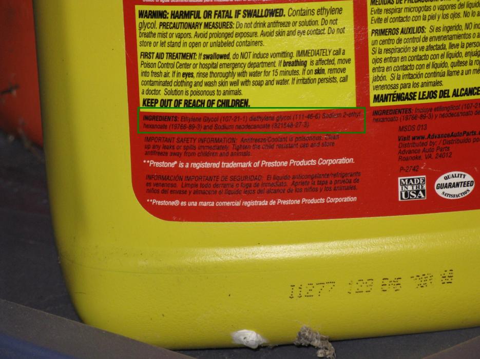

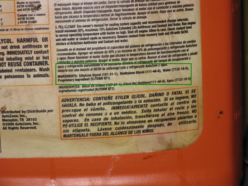

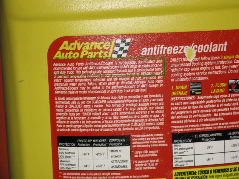

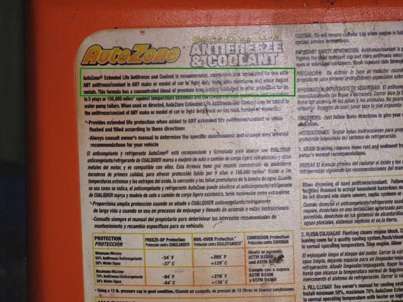

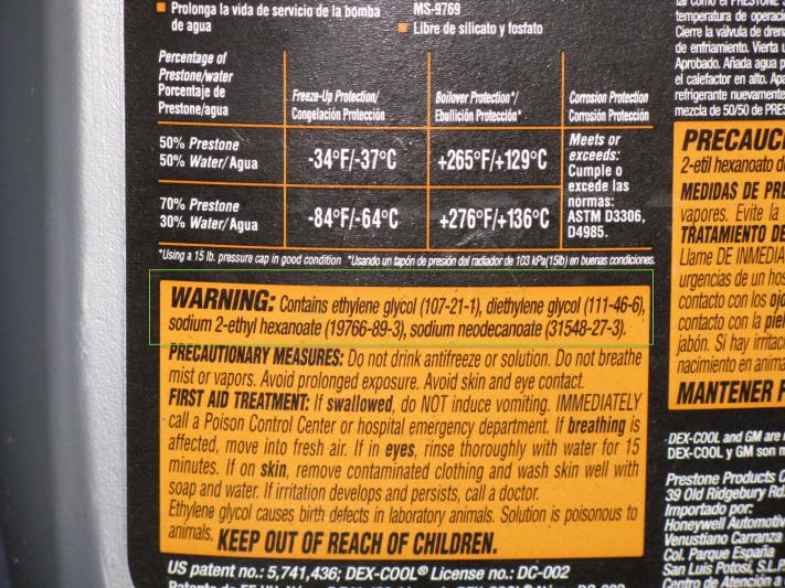

I found my bottle of Prestone with Dex and two old bottles of "store brand" green coolant. Each bottle of the "green" store brand has a statement compatible with all coolants. Now, the bottle from Advanced Auto Parts, I did not get a chance to read the entire label, since it mentions prestone copyrights, it MIGHT be re-labeled Prestone (not sure). But I did not see a notice like that on the AutoZone bottle.
Ingriedients per the back of the bottles:
Dex: ethylene glycol, sodium 2-ethyl hexanoate and sodium neodecanoate
Non-Dex (Advanced Auto): Ethylene Glycol, Diethylene Glycol, Sodium 2-ethyl and Sodium neodecanoate
Non-Dex (AutoZone): Ethylene Glycol, Diethylene Glycol, Water, Proprietary Ingredient (nice that it must be "top secret")

No matter where I look, all coolants are stating "compatible with" on it (granted, PEAK makes clear on the "original blue bottle" that it is "Compatible with all conventional GREEN antifreeze"). But if you follow the ingriedents, it's basically all the same with slight differences (one I noticed, was the peak "original blue bottle" has Dipotassium Phosphate and their "Long Life" coolant has a few others mixed in).
Unless I am missing something (as I am not a chemist), bottom line, it appears all non-extended life coolant is about the same as far as what's in it. If the stuff I call "green" because it is "green" in color out of the bottle is truly not green, what should one be buying that is truly "green" anymore??
I'd avoid the stuff that says mixes with any color coolant. Or the any make any model stuff. It's been a while since I've messed with green coolant. As I converted the cars that ran on green to G-05 coolant a while back.
I believe Peak and Zerex may still make the conventional green coolant that should work in the older cars. Or as close as you'll be able to find. I think they've been messing with the formula as most now say low silicate formula. If I was getting green coolant, I'd get the stuff that says it's green coolant with no mention of any make any model or the mixes with any color coolant. I know there are ingredients you can look for to make sure it isn't the Dexcool clone stuff. But usually the Dexcool clone stuff says any make any model, or mixes with any color.
Well, last time I checked, ALL coolant on the shelves at the parts stores I buy coolant from have that blurb "Compatible with all anti-freeze".
