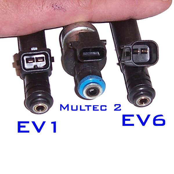

Ok so for the injectors I am going to order them from ZZP but idk which connector they use. any idea? The picture below shows the different styles you have to pick from.
