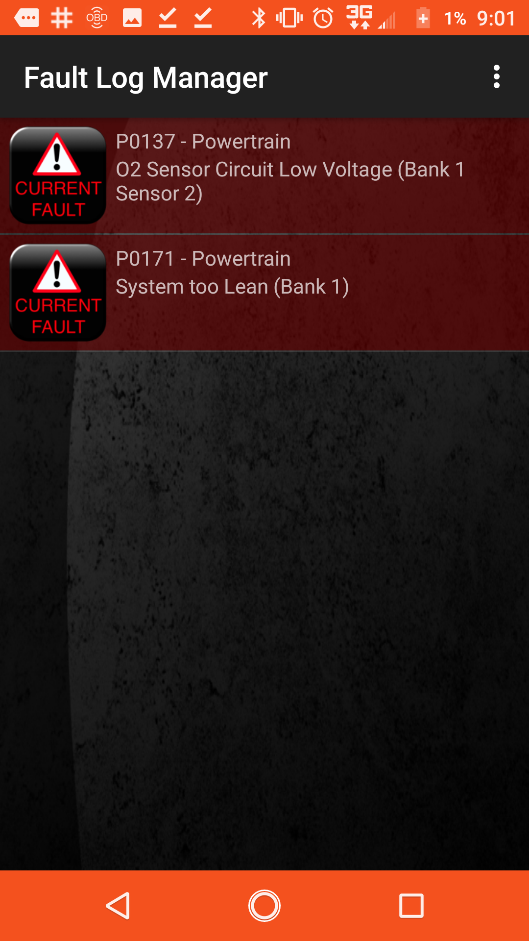

Here are the codes from my Elm-II and I have scanned it with a Bosch at the local parts store and used a friend's konwie. All the codes.
I have a 2002 Monte Carlo 3.4L and Now I'm curious about which one is the most likely cause of it running to Lean(P0171). I know I have a exust leak, So that's one issue resolved when I can replace the whole thing but I'm pretty sure this is not the main issue. Replaced 02 sensors last year with Bosch upstream and downstream sensors, Now I wish I went with A/c Delco since it's a GM.
I had the catlylic converter replaced last year with a magnaflow also since the honey comb was plugged up.
Any help would do for help on any code & Thank You.

A faulting O2 sensor can make the car run lean.
Old Jan 8, 2018 | 03:12 PM
Where's the exhaust leak? If it's before the sensor, you could be getting inaccurate readings and the car leaning out when it shouldn't.
