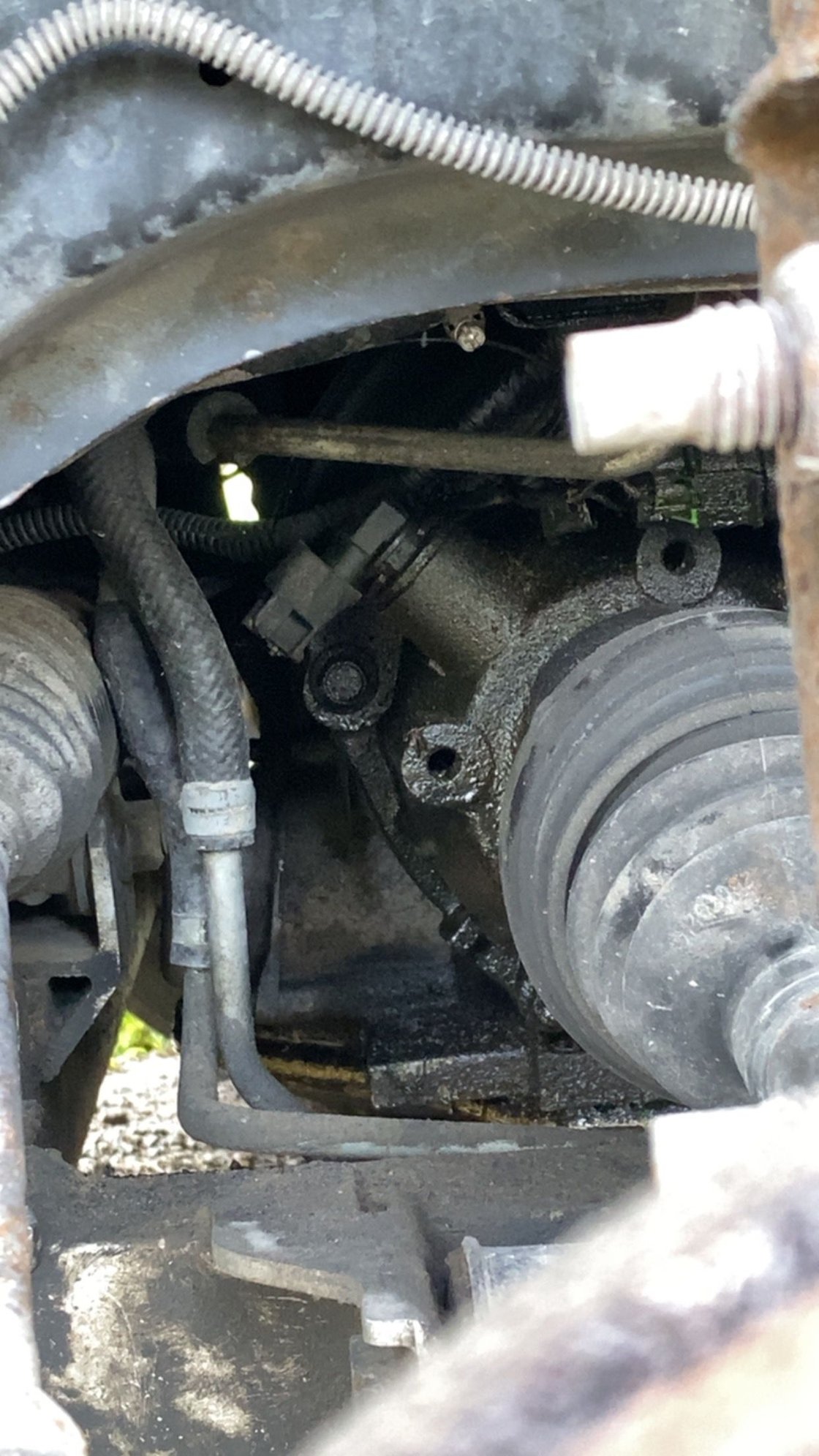

I’m hoping someone will be able to help me. I bought this 2005 Supercharged SS and the speedometer doesn’t work. I crawled under the car and spotted this connector completely cut. I believe it’s the VSS but I’m not sure. I don’t know if I can replace the whole harness or not. If anyone can give me a part number or name to replace it I would greatly appreciate it. Thanks!

That is the VSS. I don't know if you even can buy a harness anymore - Id just hit a junkyard to cut a plug / pigtail off a car there and splice that into your harness. You'll be back up and running for virtually free.
