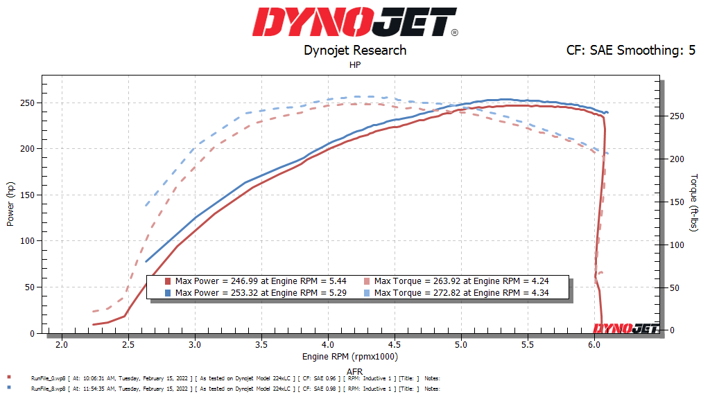

So I got it done a couple weeks ago. Not worth $600. 11 HP gain a bit more torque gain is all. He told me to take out the DIY CAI I made because the ECU could possibly get fried so I put the stock box back with a k&n drop in. I also found out my front upper motor torque mount was broken, the 1 people flip. Anyways after replacing that the car launches a ton better. When I took the old bushing out the middle part just fell out.....

As for the minimal gains from the dyno tuning, if my memory serves that was mentioned as to the expectation with a pretty close to stock vehicle.

he called it the PCM. I'm new to these cars this guy is the best at LS engines in Sacramento look up his reviews or if you have instagram @holeshot_performance he works on gnarly cars every day and is usually all booked up i got lucky. I reposted my dyno results because I did not see them prior after someone asked my #s. He knows what hes talking about, its me translating it incorrectly because I know barely anything about LS4s so please without starting **** dont insult him until you check out what he really does, that being said $600 still not worth it.
No offense intended, and I'm really not trying to tick you off here - but I'm not sure what else you expected. Id mentioned previously in this thread that stock LS4s only get about 10-15 wheel and it sounds like that's right about where you landed. Theres just not a lot of meat on the bone there from the factory.

I should have chimed in sooner, but there is something to be said here for a dyno tune vs. street tune. When tuning your pcm to the dyno, your looking for a "numbers gain". The timing is adjusted to make bigger power on the dyno machine. That does not always translate to a faster quarter mile time because the dyno can not perfectly replicate all the real world conditions like load, resistance, etc. Dyno tuning is great if "the numbers" are what you are after - that is the goal for a lot of builds. But if you want the car to go it's fastest, a street tune is better. If you can get you mechanic/ tuner to the track with the car, you could see additional gains in actual speed as he dials it in there.
But it's still probably not worth it until you've built it up a bit
