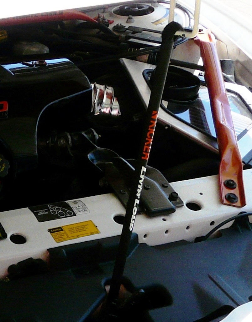

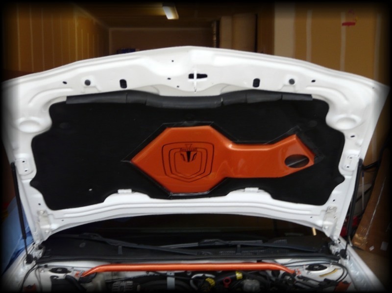

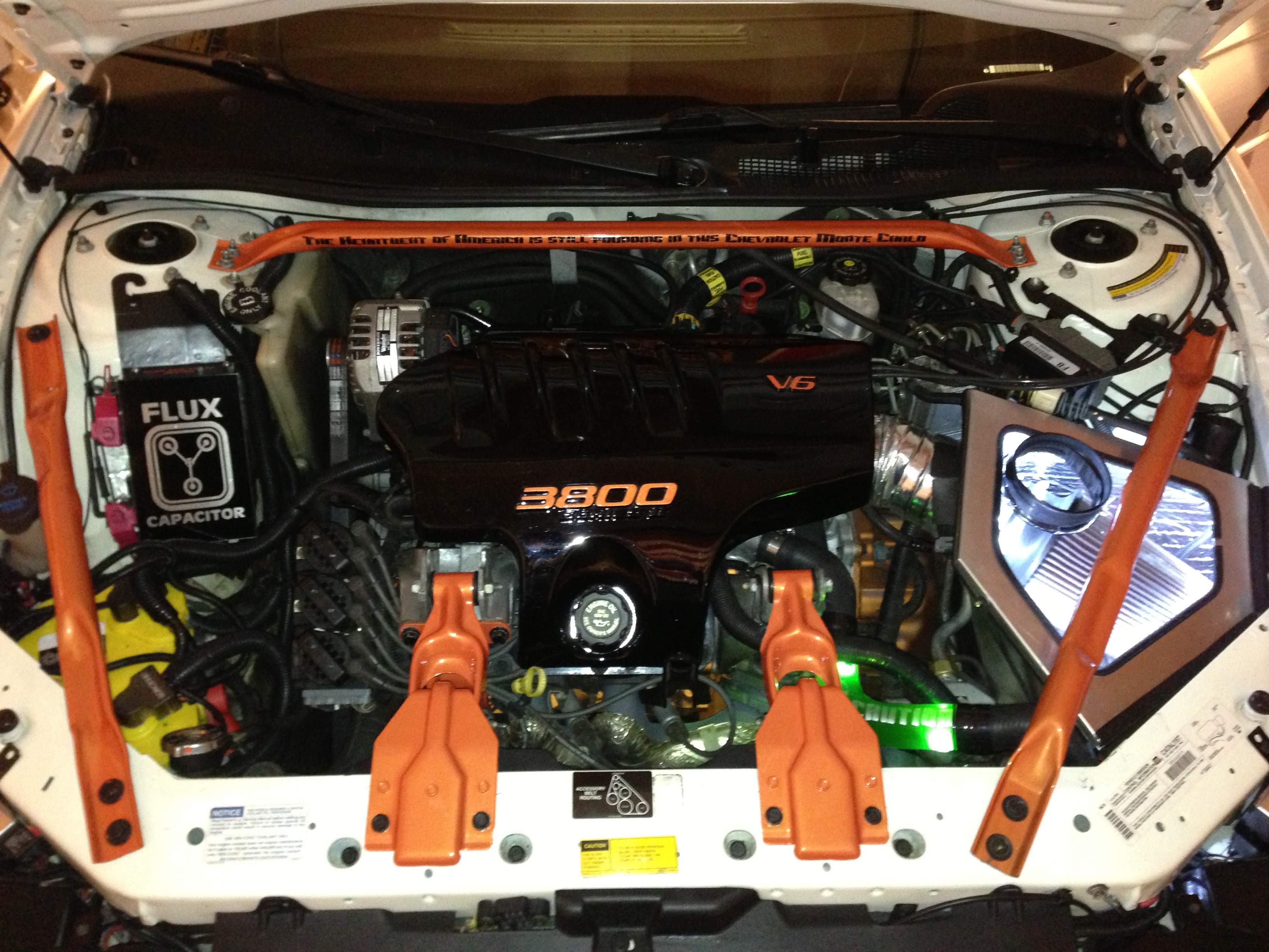

OK MY MPD-1 HOOD IS FUNCTIONAL and sealed behind the headlight to help build the most out of the hood and packing the air box with pressure. What I have noticed was that at higher speeds (HWY) I get better gas milage 1 to 2 MPG and a very and I mean very small boost of power amount of power on my Naturally Aspirated v-6 . I did mine because I feel its how a true SS should look . I would do this again 100% but if you are looking for more power or better gas milage it s minimal at best. I would bet the best way cost wise would be pull the drivers side headlight and seal that intake area behind it .It would give you the biggest performance gain for the $ with your Super charged Monte once you are moving.
I have tons more pics let me know if there is something you want to see

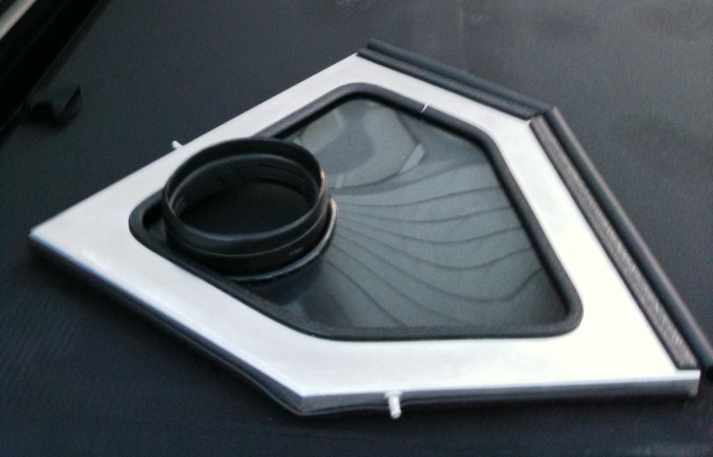

How i mad the cold air boat and hood marry up ,its a Wizard air box I had to go way back to find that info LOL and then I cut a hole in the plexiglass and added the ring that I made out of a big rig cv boot and I urethane that in to the glass https://montecarloforum.com/forum/pa...ook-now-23491/
