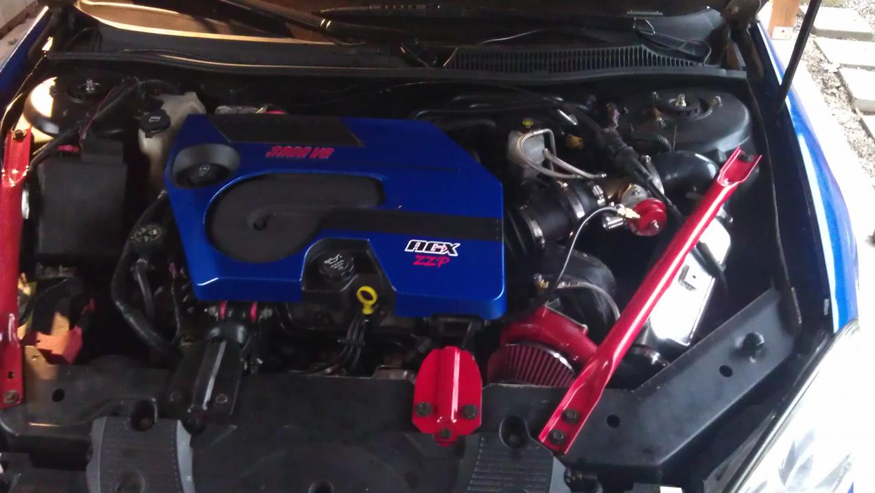

Not 100% finished but here is and update shot.

Well the injectors didn't fit so I just installed the old ones and got her to run.
Engine.mp4 - YouTube

That's how these things go when there is limited info on modding an engine.
I just started tuning and just with 5 psi the stock injectors run at 120% duty cycle and the MAF is being pushed to its limit of 11500hz at about 11100 hz. So before I go any further I'm upgrading those parts.
