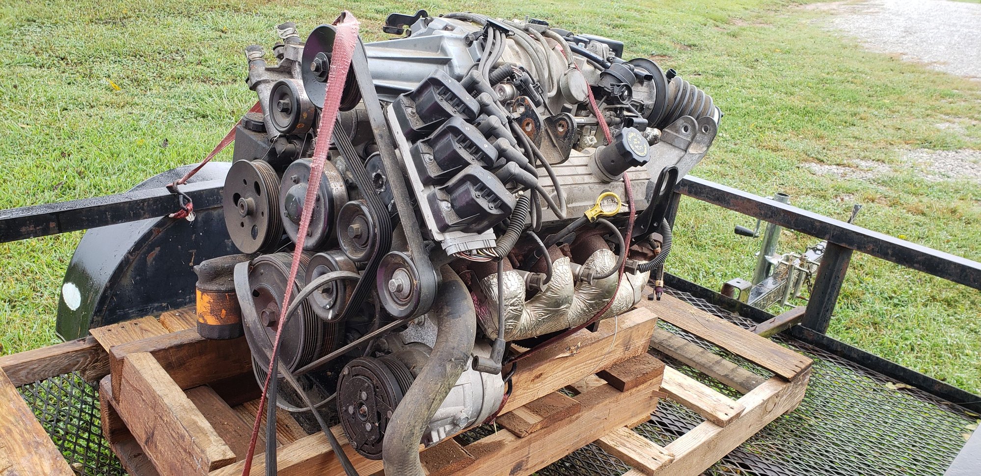

Hey guys back again. I have the L67 engine with 100k miles and fixing to buy a 4t65E fully rebuilt to go with it. I'm swapping my 3.4 out of my 03 LS with the L67. My long turn power goals are 300 HP at the crank. Is there anything I am missing or need to take into account? Will the non HD version hold 300 crank HP?
