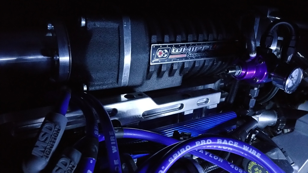

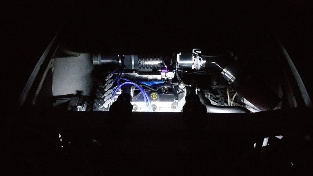

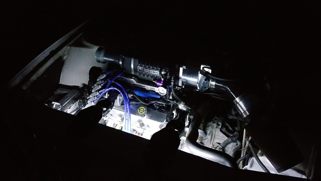

It shouldn't be more than a couple weeks until I take her out. At a bare minimum, it needs exhaust and a tb cable bracket to make it drive. Obviously there are other things that need to be done before I drive it a lot, but those are the two key pieces. I just recently got it plated and insured, so we're close for sure, it's just a matter of finding time to finish the last couple projects.
On a side note, I took a couple of neat pics in he dark with my new underhood accent lighting. Thought it came out kinda cool. Doesn't look as cool as when the engine bay was more empty, but not much you can really do.

You have been holding pretty tight to your schedule in buttoning up your Monte and getting it back on the road. The obstacles you have overcome on your own are moments to be proud of, wish I knew a 10th of what you do about cars.
The engine bay lighting is nice, like the crisp effect of your white light choice, really makes your black and chrome quite dazzling in appearance. Think the underhood lighting mod is something I want to do now. A few members have done this and it is really a nice touch. Good job!!
