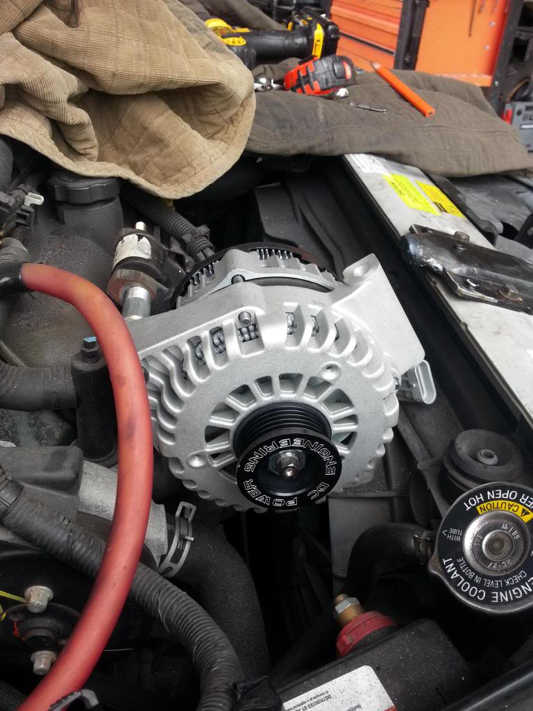

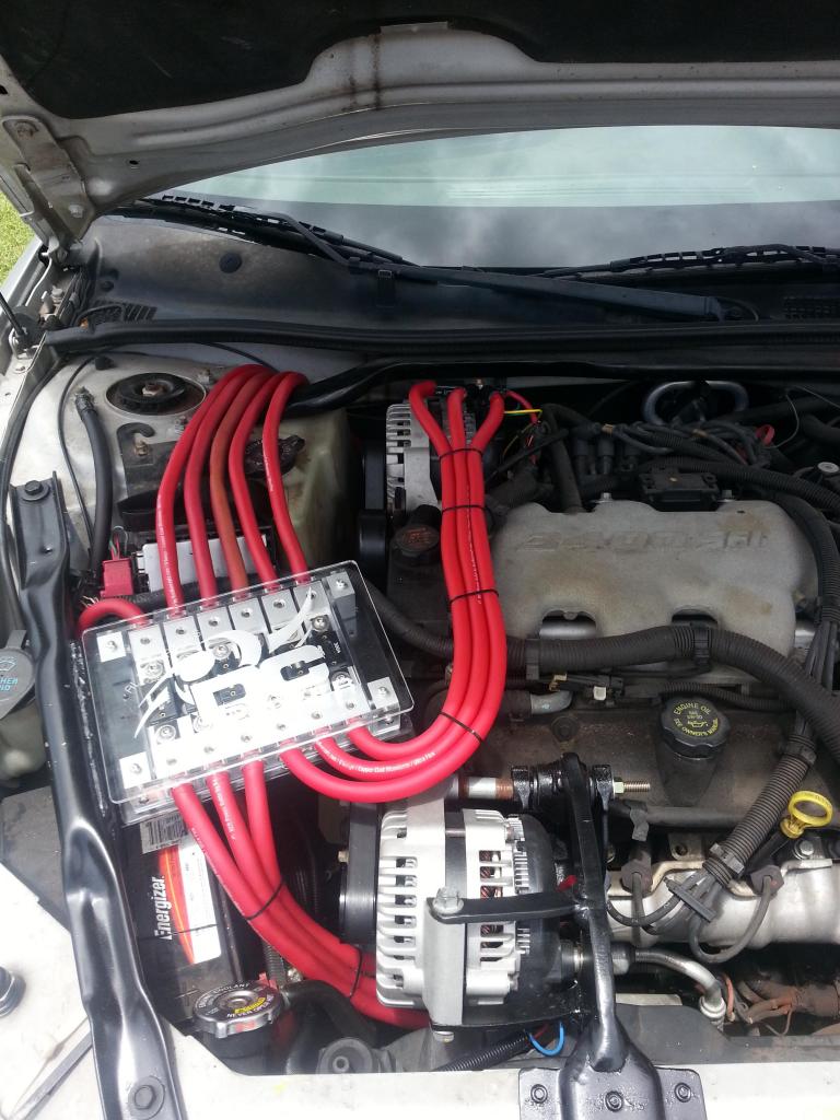

Originally Posted by boxman420
heres a little setup we built on my 01 ls.. Basically cut the center motor mount off..
Attachment 30404
added another pully.. Welded supports and thicker steel to help with the extra tension.. This pully in the picture is not the one we used in the end. We ended up with a 4inch pully because this one was making the belt slip on the power steering pump..
Attachment 30405
got it all lined up..
Attachment 30406
mock up for bracket.. This second alt is a actual monte carlo alt.. I could flip flop the two alts if i ever felt the need too..
Attachment 30407
hmm
Attachment 30408
all working and painted.. With additional custom lazer engraved fuse block
Attachment 30409
finished and looking pretty.. Still minor things on the bracket need to be changed.. As in the spacer and it needs a better bolt in the back
Attachment 30410
