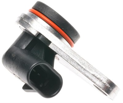

Edit: The camshaft position sensor looks like this:
It is located on the engine block behind the alternator roughly between the crank and water pump pulley.
