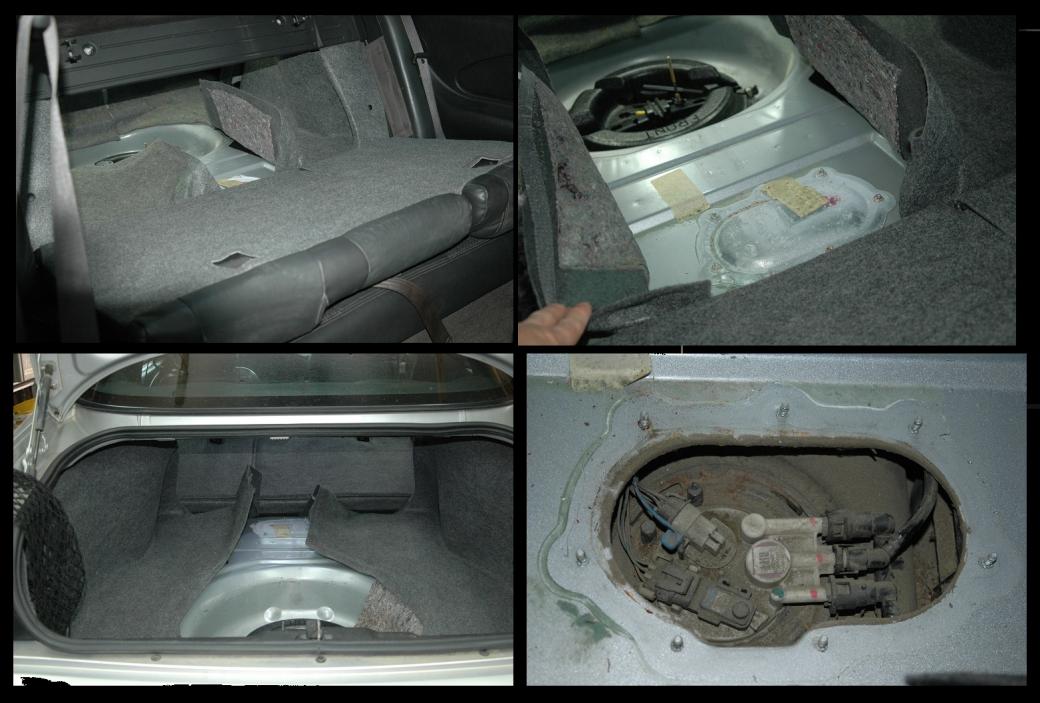

Unfortunately i do not have access to a smoke machine nor do I have the fine troubleshooting skills needed to directly correct this problem. So, taking the advice of the above link, I accessed the top of my fuel tank through the removable panel in the trunk and replaced the fuel tank pressure sensor. It was very easy. I cleared the code and will let everyone know if it cures my problem. The code always came back within a few days. After a week I'll update this post.
Please see attached images I have prepared for everyone.
