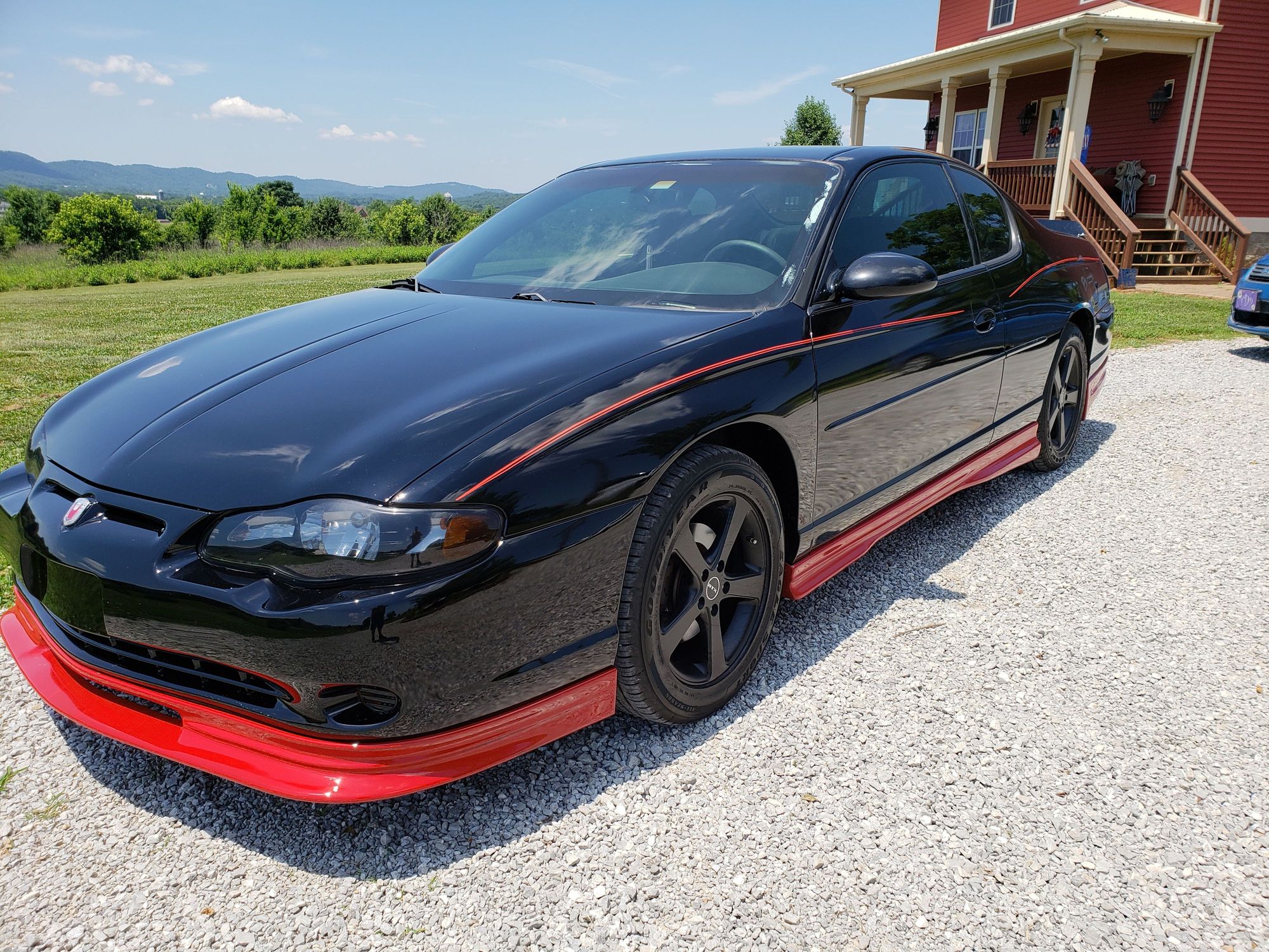

Welcome BTW.. Lets see some more pictures of your car.. What is that, a razzi kit?

Thank youuu and right now I have about 2000$ to put in it but as time goes by I'll have more to put in. And yes it's a razzi kit
