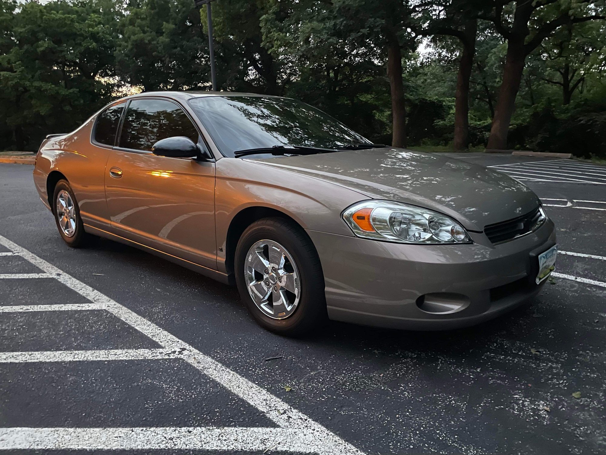

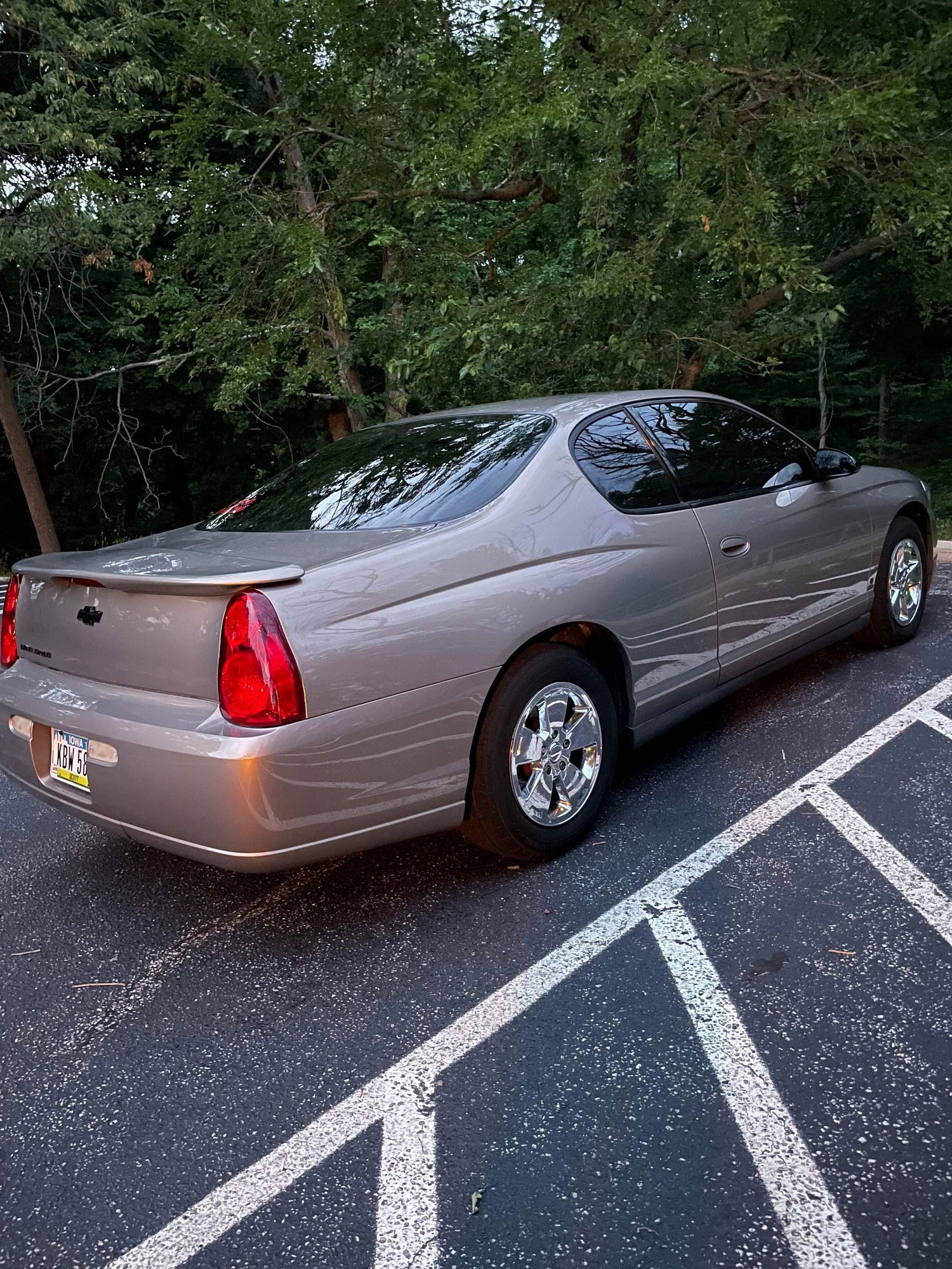

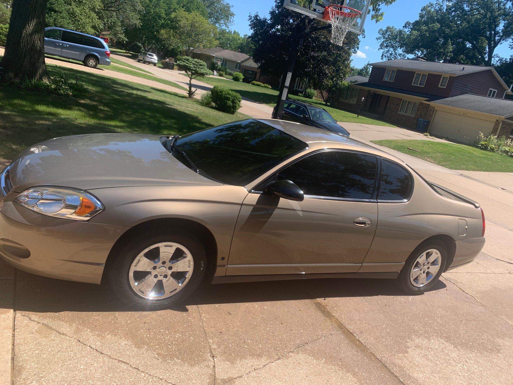

Hello I have a 2006 Monte Carlo LT with the 3.5 v6.
I love my car but want to do some performance upgrades to give it more power but keep coming to dead ends on info about my engine or mods etc.
I have decided I want to swap a 3.8 v6 into it to have more flexibility with upgrades.
I’m currently trying to understand what all is needed for this swap to happen and don’t know where to start, I am currently struggling and all help is much appreciated!!! Thanks
