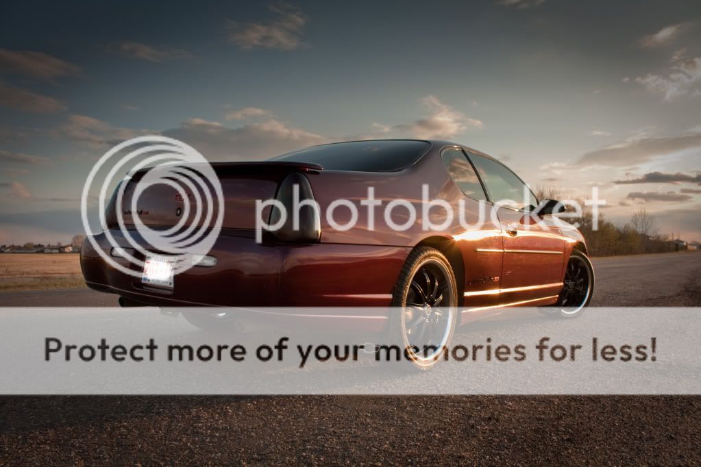

I tinted my tail lights & I think it looks 100% better. I fine-sanded them down first to reduce paint chipping. I didn't bother clear coating them because I liked the matte look to them. Very easy & inexpensive mod
