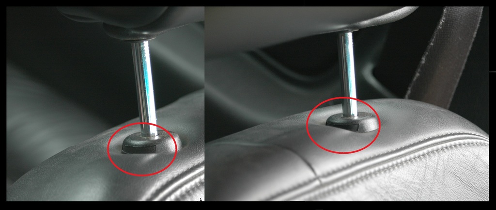

Old Mar 22, 2015 | 11:22 AM
gmjunkyard's Avatar
Joined: Jun 2013
Posts: 67

I got the headrests out by putting a small allen wrench in the pin hole then pressing the button on the other side again. Easy when you know how, lol....
