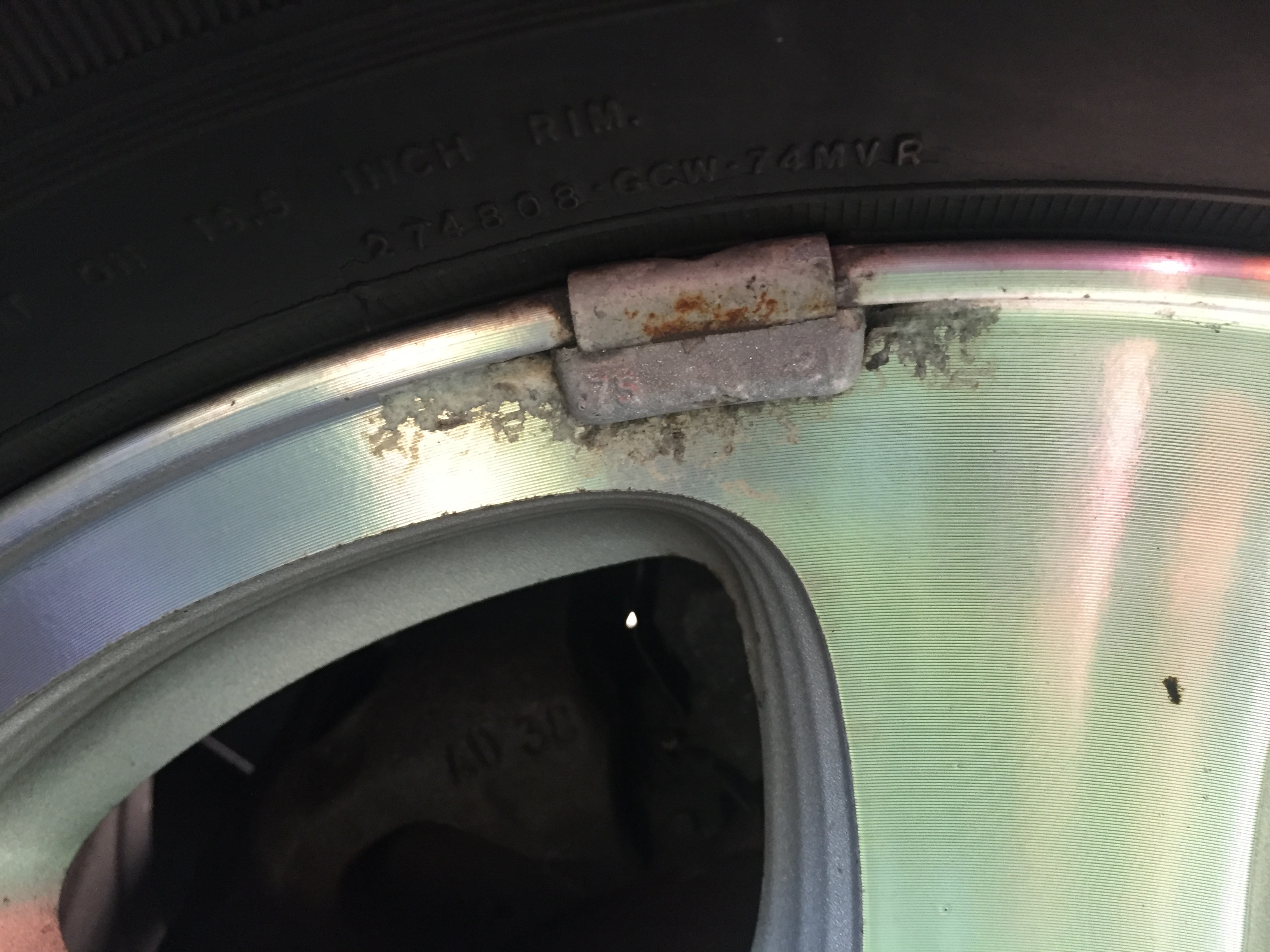

I have the attached style rims on my 2003 Monte SS. As you can see in the pictures, there is corrosion under the clear coat. The clear coat is peeling off where it is corroded.
Can these style rims be refinished the same way as described in this thread? If not, any suggestions on how to fix these? I would like to try to save them.
Any help would be appreciated. Thank you.
