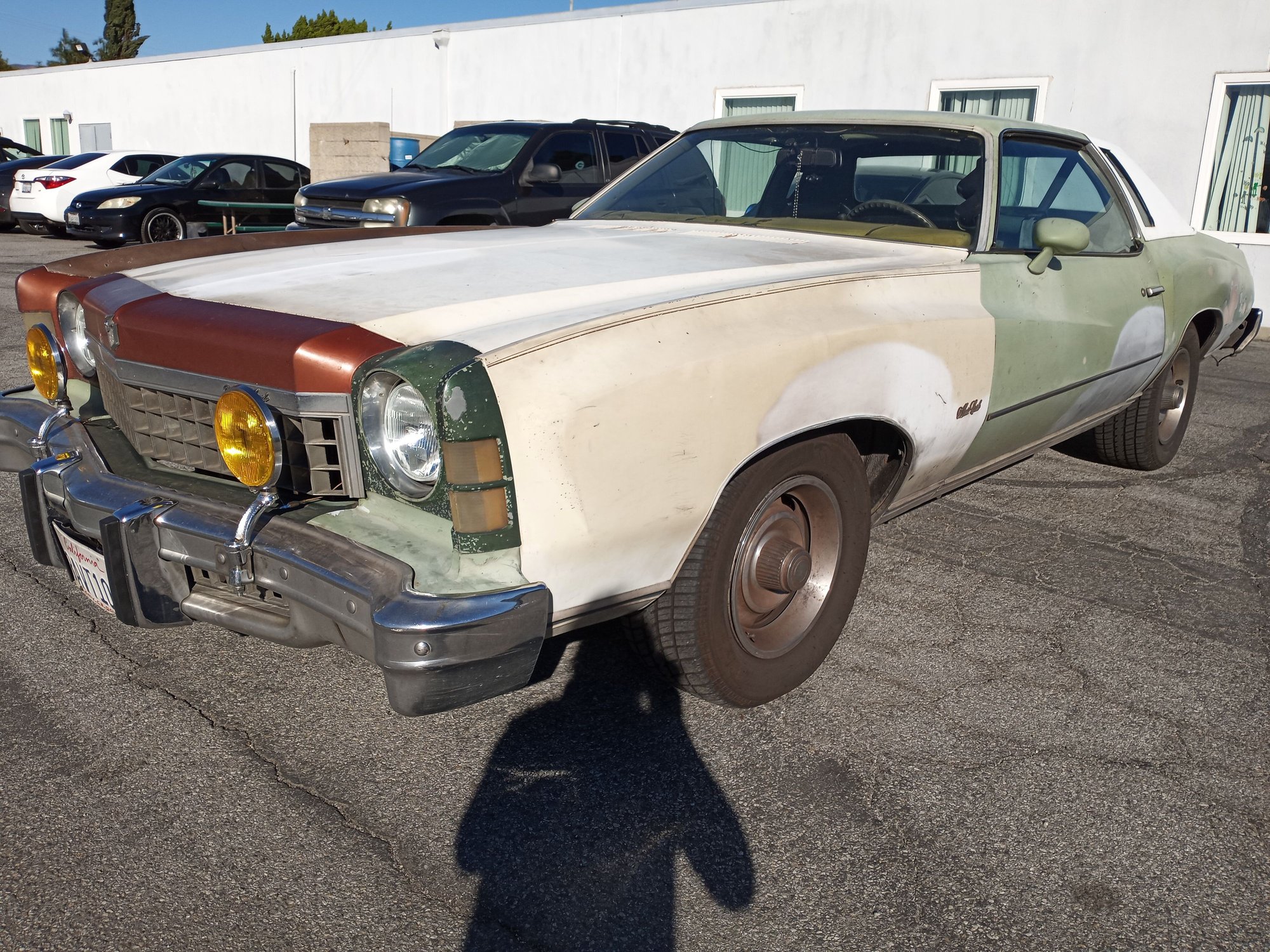

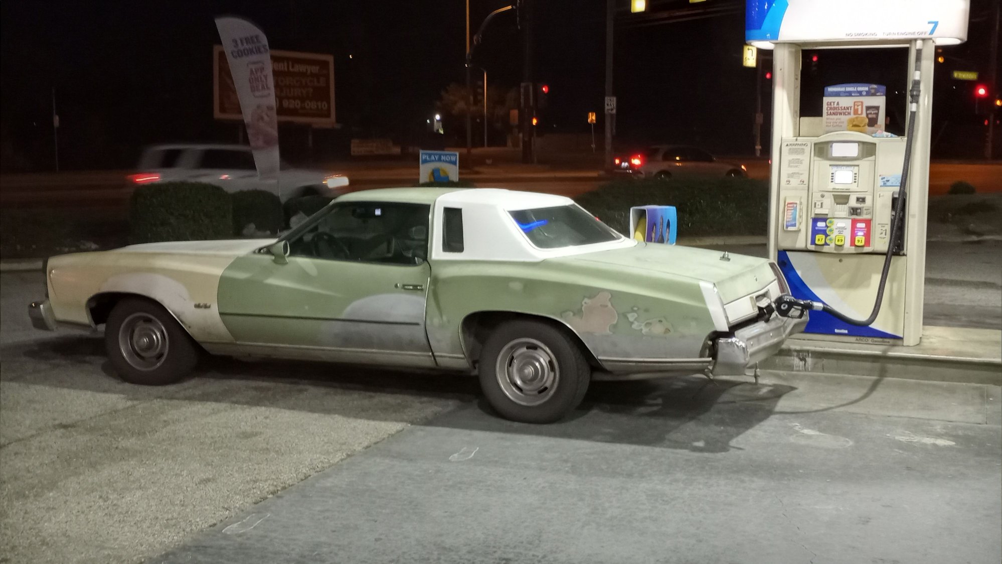

The correct rally wheel for that car is 7"×15", code FW – the code is stamped on the wheel next to the valve stem.
The original tire size is GR70-15; the closest modern equivalent is 225/70R15.
I run 255/60R15 all the way around which fill the wheel wells nicely, negligible change in speedometer reading, improve handling and don't rub on the frame.
Are you wanting to run two different tire sizes? What's your ultimate goal with your car? Unless you're building a dedicated ¼-mile sprinter or a trailer queen show car, I urge you to reconsider.
