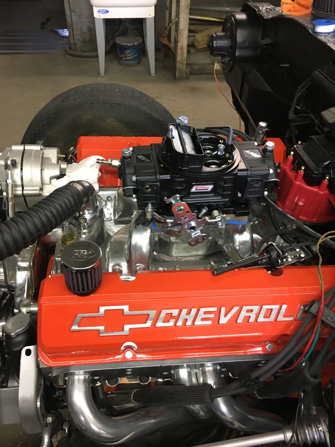

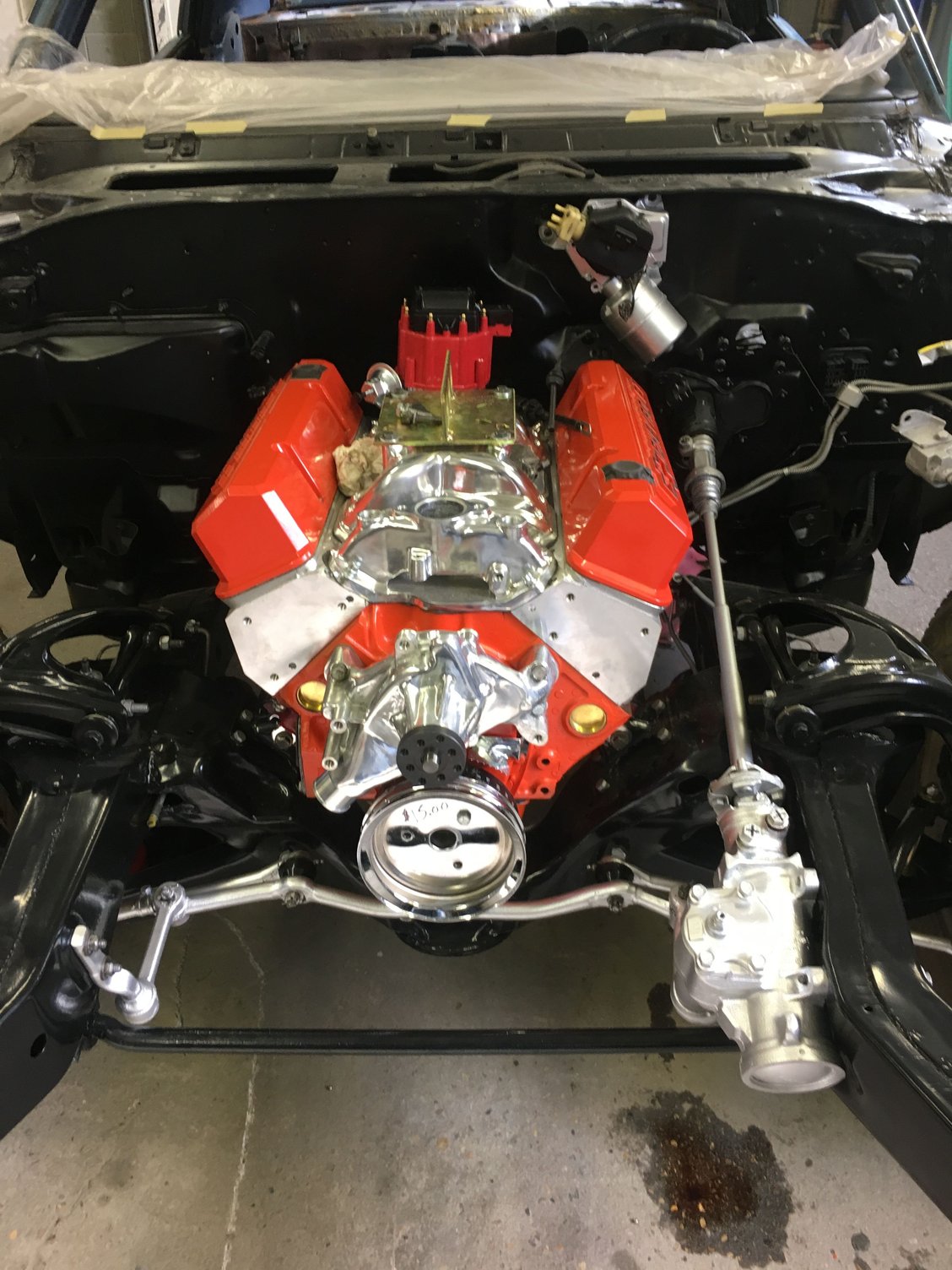

it' a frame off resto. frame sent out to be sand blasted, semi gloss black powercoating done to the entire frame and suspension parts. new bushings, new shocks 1inch drop in the front, cargo springs in the back, built 406ci sb, built tranny, built rearend with Eaton limited slip, quick fuel 750cfm carb, long tube headers custom ceramic coating done by a shop where I live. it'

Great pictures, gave me flashbacks of laying on my back doing about the same thing with about all the same parts. A lot of time and money was probably spent getting you that far but just think how close you are to completion. I did notice in your pictures that the driver side valve cover has a breather in it and appears that the passenger side has a PVC valve in it. I avoid doing that because oil will allways leak out of the breather and onto the cover . If you get a sealed cap on the drivers side the system will produce enough vacuum to keep the oil off the covers and help seal the rings by reducing blowby even with a big cam in that 406. Just wondering about your engine, which crank and rod combo did you use ? I used a Eagle crank and rod's with the 5.7 rod and was very happy I didn't need to get a special cam.
