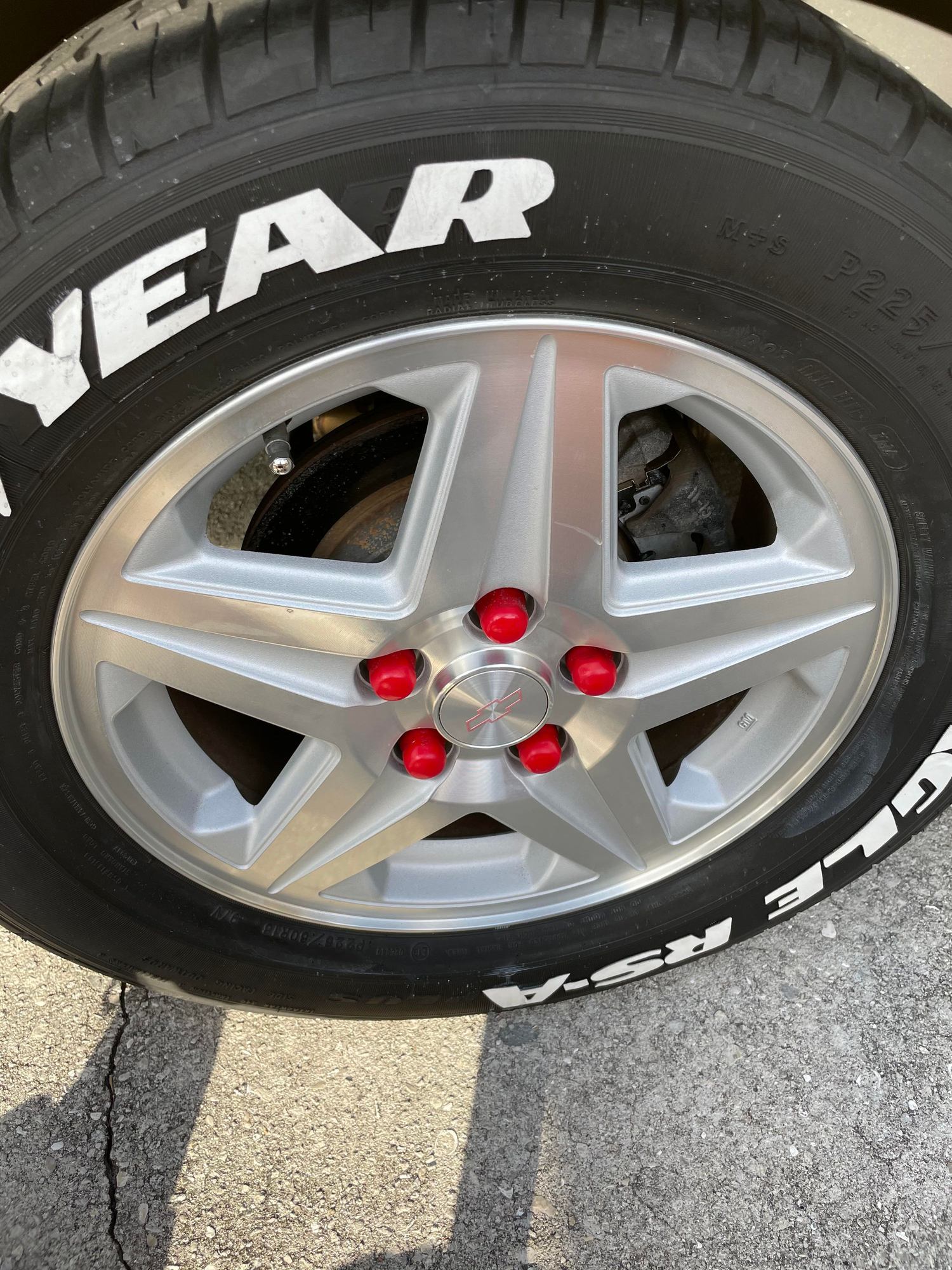

Old May 23, 2021 | 06:26 PM
Onion39's Avatar
Joined: Sep 2015
Posts: 140
So I finally got these done. I ended up skipping the steel wool as it was scratching the finish a little bit. I did the following on all four rims:
1. Clean and degrease using Chemical Guys Clean Slate/Super Clean
2. Clay bar
3. Compound and polish using Chemical Guys V32/V38
4. Wax
I realize there are better compound options available but it was all I had. I'm pretty happy with the finish. They are far better than how they started, but not 100% complete I don't think.
Excuse the crappy photo. I'll try to get some better ones when the sun is out.
