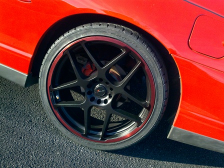

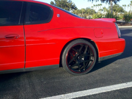

Default Bigger than the GXP upgrade?
I have found the GXP upgrade on ZZP's site
It would be 13" rotors front and rear.
However i was wondering if there was anything that would be bigger?
I recently Upgraded to 20" Wheels (not donk or ghetto or whatever)(looks clean and sports) and the 13" rotors are only a little bigger than the stock 12" up front...
NEW WHEELS AND TIRES!!!
SMALL BRAKES!!!

Anything bigger is going to cost more than reasonably priced f-bodies. In my opinion The GXP's are expensive enough. But that's besides the point of interest. I think there is a 14" option out there or atleast there was but at the time it was almost a cool grand for the package.
