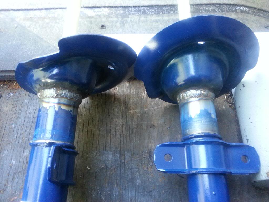

For anyone who is interested in how we get 24's or bigger on these cars heres a pic, cut the factory welds, lift the spring plate and we re-weld it. This is the right way, no lifters or stuff that messes up the ride. Anyone in the Chicagoland/Northwest indiana area that is interested pm me for prices.
