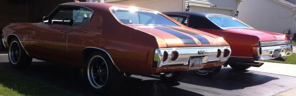

I had 245/60/15 BFG on the front and 275/50/15 BFG on the rear of my 72 Monte. Front had 15x8" rallys and rear had 15x10" rallys. Not lowered, but had air lift shocks on the rear. Had to keep it fairly firm in the rear to handle the bumps with the 275s. Yes, the Chevelle was mine too...

very nice. love 72 montes. some day ill get one. do you remember what kind of backspacing you were running? i know the 1st gens are very different from the 3rd gens. i run 8" prostars on mine and with the 3.50" backspacing with a 275 its a tight fit but no rub or sticking out.

I believe they were 5.5" BS front & rear. Pretty sure. The problem is the stainless steel trim around the wheel well. It sticks into the well too far and will cut a tire like a razor blade. My friend bought the Monte back from me and has since trimmed the wheel well trim at the top. He still has the same wheels & tires on the car with no rubbing issues.

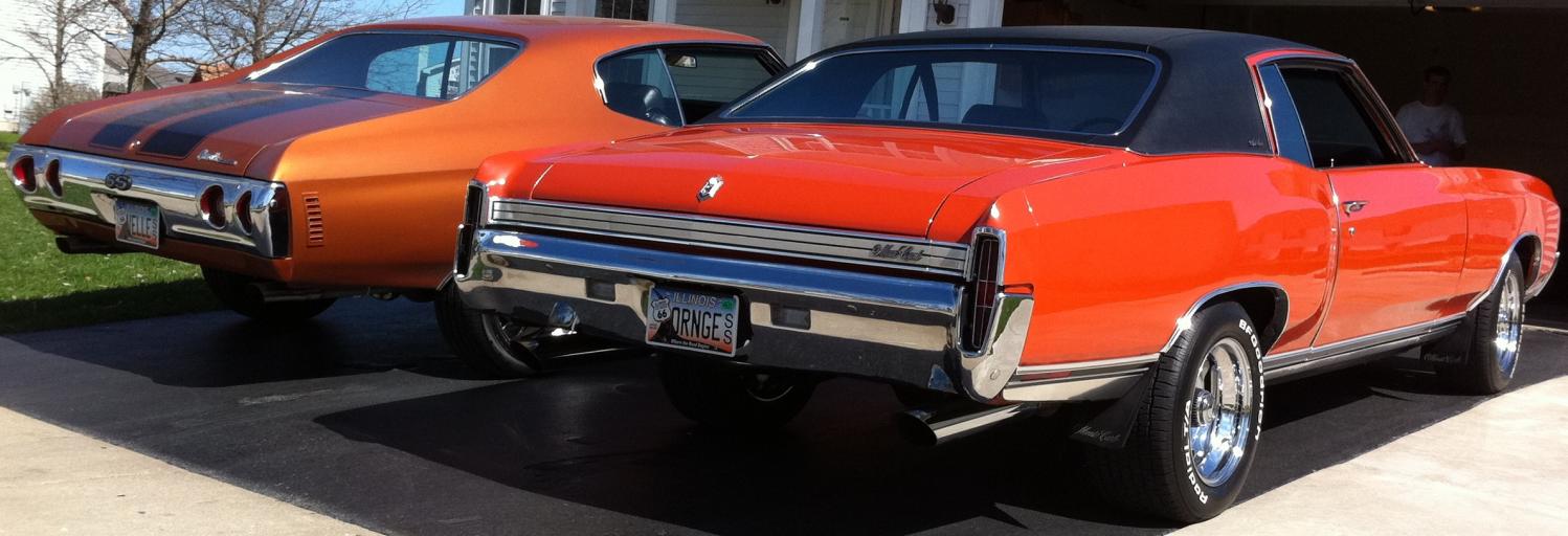

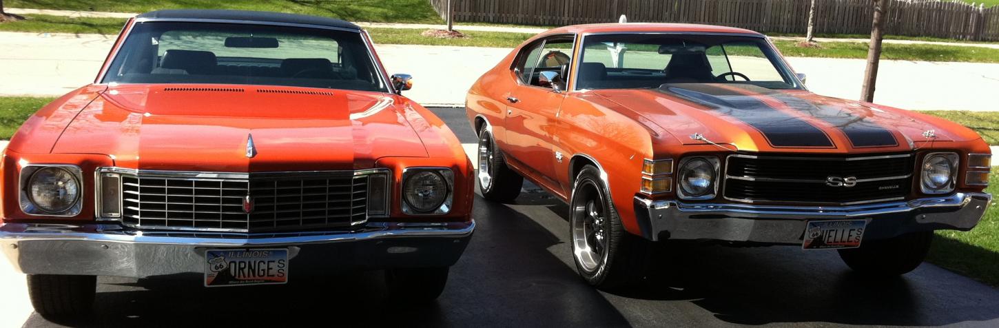

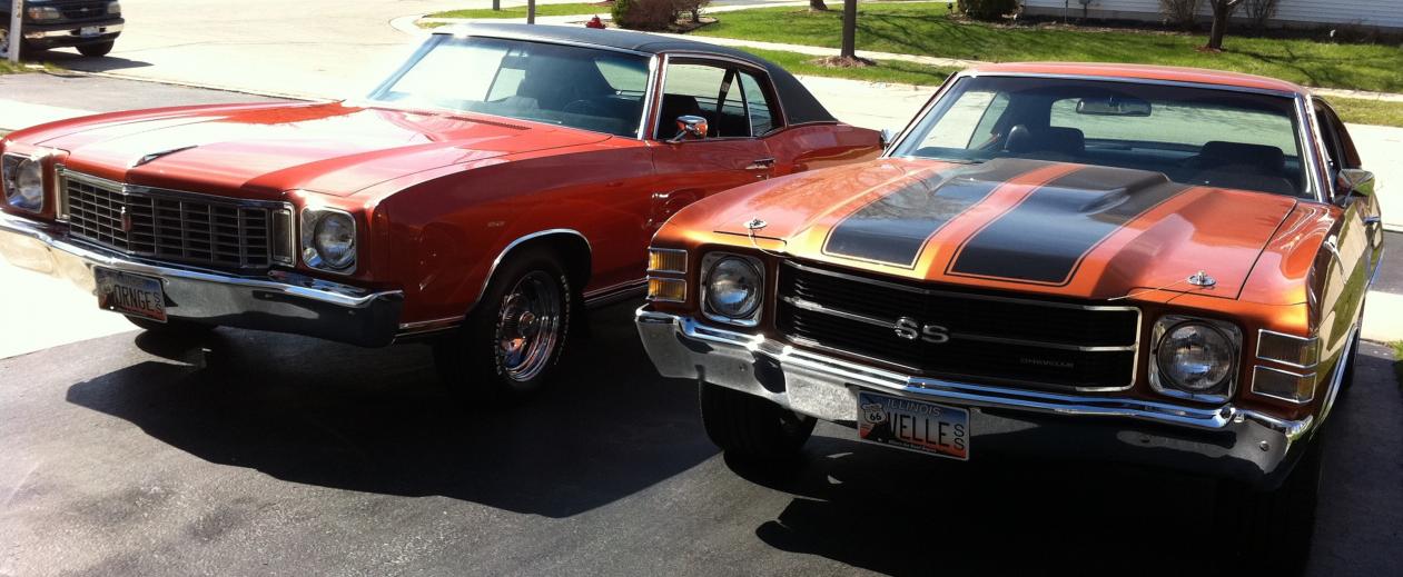

Thank you! I still find it hard to believe that they were both mine at one point...more Chevelle/Monte Carlo eye candy:
