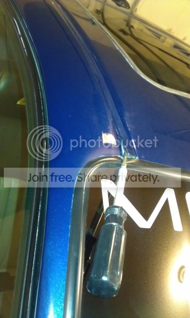

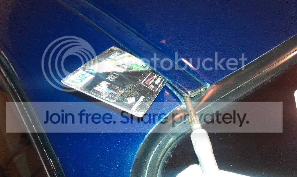

Ok. You’re smart. I'm NOT! How would a dummy do it smart? LOL any ideas or hints on removing the rails safely?<?xml:namespace prefix = o ns = "urn:schemas-microsoft-com<img src=" /><o:p></o:p>
Old Sep 11, 2012 | 02:33 PM
Lol to remove the factory pieces, i just get a screwdriver under the end & use a card to slide threw the tape holding it on
Old Sep 11, 2012 | 04:34 PM
01 Monte SS's Avatar
Posts: 2,886
From: Ames, IA
X2 on Mike's Method. I used an old card from my wallet and it came off with nearly the same line as the roof. They can easily be put back on if you remove them properly and take your time. No need to rush the removal
