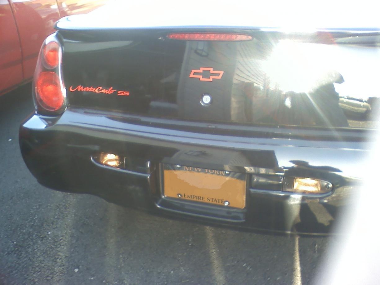

However I have seen some nightshades come out very well like you said, and others not so much. The key is mostly patience and consistency. I have done these on small parts like reverse lights, my friends cav headlights and my trucks tails and they came out pretty decent! Also you should only need one can and get some clear coat to protect it.
Here is the write up i followed: VHT NightShade Application
Like i said IMO i would perfer covers because they have a nice glossy finish, they are both consistant, and you can take them off on demand.
If you choose nightshades remember not to go too dark, i think the can recommends no more than 3 coats so i would stay in that range (I did for 2 of my 3 projects and they came out perfect darkness). I hope this helps and GOOD LUCK!!

No problem, here is what 3 coats on the reverse lights look like...
Attached Thumbnails tint tail lights.-hpim0699.jpg   tint tail lights.-tinted-reverse-lights-2.jpg
