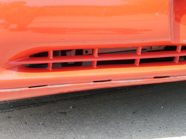

You will have to cut 13 slots for the tabs to fit thru the bumper. Then you will need 13 clips and 7 screws that hold the part on from the bottom. Also you will need 4 rivets where the lip attaches to the inner fender. Here are a couple of pics what the slots will look like.
Attached Thumbnails Putting pace car body kit and wing on 02 MCSS. Help???-p4160104.jpg   Putting pace car body kit and wing on 02 MCSS. Help???-p4160103.jpg
