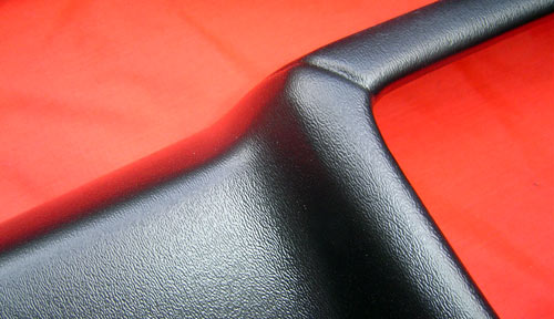

Without question, use SEM vinyl dye, no sanding is required (except to remove your peeling) dry's in a just a few hours (requires at least 48hrs before setting completely)
and looks OEM!
You will need plastic adhesion promoter to help bond the new dye to your console. i recommend the two following cans of SEM products.
SEM 39863 Plastic Adhesion promoter
SEM 15013 Landau Black color coat
Attached is a pic of a completed vinyl dye job.

If you are talking about the actual top part of the console base, there is just a plastic coating over the bare plastic. If you sand/peel the coating off you can just paint it like you would bare plastic. Sand, apply adhesion promoter then primer-paint. Not quite sure how to remove the consol, have never done it before.

if your using SEM products, do not primer, there is need for it.
also, remember if you decide to paint (spray paint) then you will never be able to use vinyl dye, it clogs the pores of the plastics and will not let any dye in.
