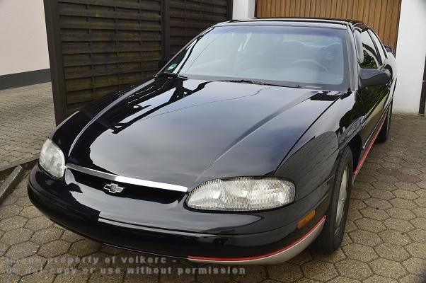

Who can tell me how this piece mounts to the car? What mods needs to be done? Can't seem to find anything but only photos of attached spoilers.

Posts: 136
what i was wondering is if the old bumper needs to be cut or is it mounted over the existing piece. from the pictures out there i think i have to get rid of the silver moulding and then screw it on like you said. i mainly would like to know if existing pieces are need to be replaced or cut and "destroyed".

Thanks everybody for the input, seems like an easy installment.
But again, what about the molding that is now painted red on my Monte, it has to come off or gets covered by the rk sport piece? Correct?

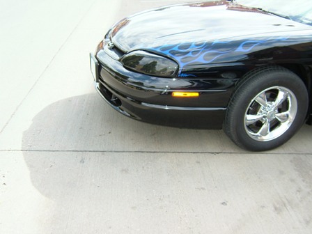

Old Dec 29, 2013 | 10:07 PM
Posts: 5,511
Leave the Molding alone the Valance will cover it and you won't see it any longer It will hold the valance with the 3M tape on. I believe it would be more difficult to mount with it removed I asked the same Questions. When we put mine together. It will then look like the front photo that I have attached.
