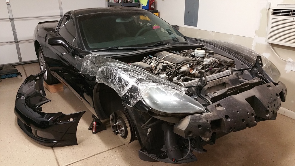

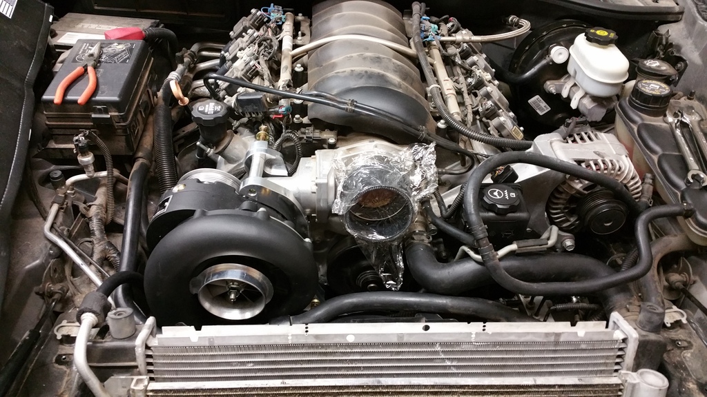

Here are a couple of pics of the progress - one with the car stripped down and ready for work, the other with the blower in place for a mock up.

Here are a couple updated work in progress pics:

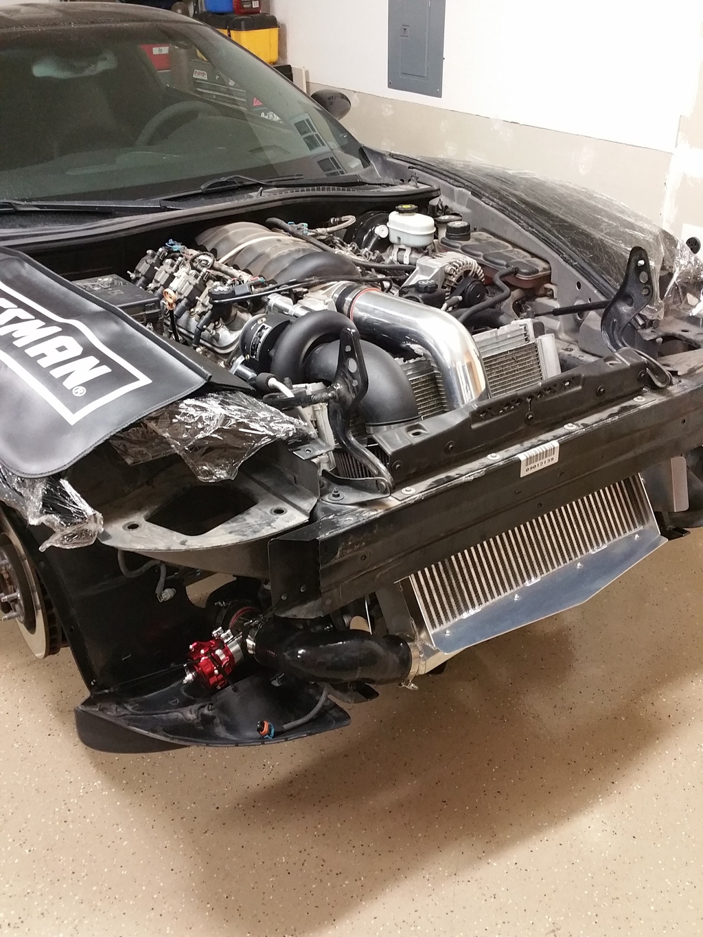

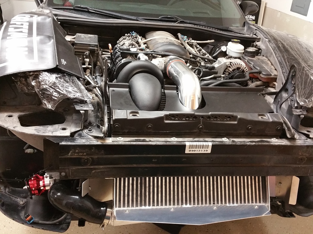

Here's a cool wip picture of them together:
[IMG][/IMG]
