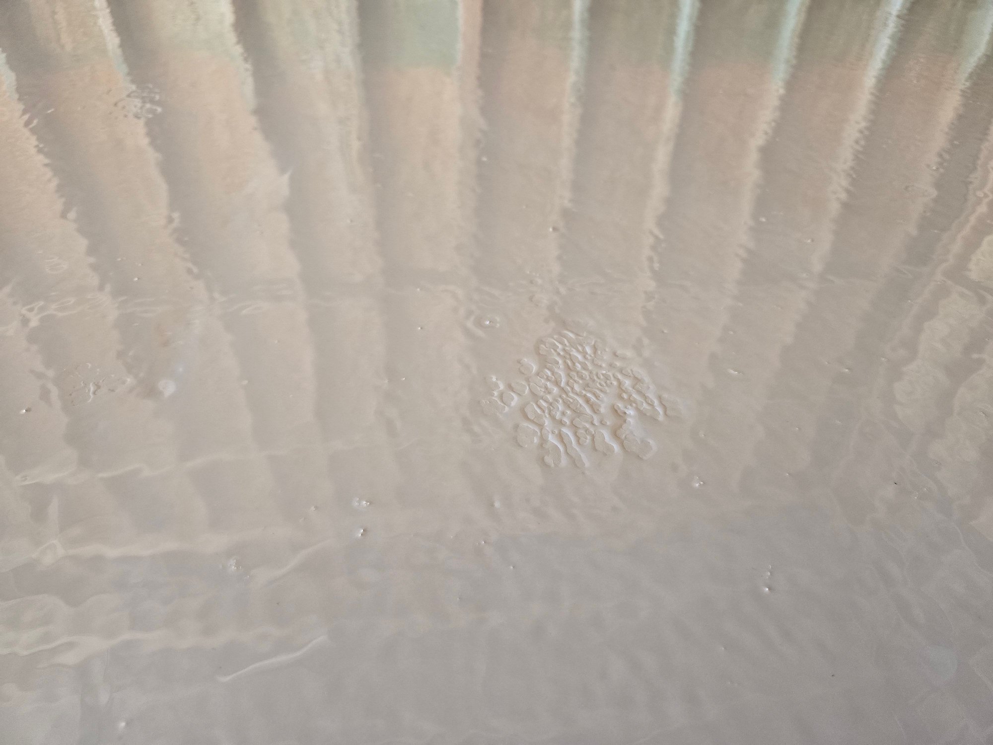

Well today didnt go to plan. Went out to start at about 12 hours after epoxy (the min top coat time, 24 hrs is max) and the epoxy was still awful soft on the surface. It was soft enough my sandals were leaving light imprints in the surface (not that it mattered much as the clear will smooth it all out anyways). Its been about 40-45 F overnight, so I figured that just slowed the set time a bit. Gave it until 14 hours and it had set enough to walk on without any imprints.
Started to apply the polyaspartic clear and immediately ran into issues on the first 1 gal test mix. It doesnt want to stick to the epoxy - its like oil and water. I did my usual: pour a line shaped puddle, drag it across the area to cover with the notched squeegee, then backroll it with the 1/4" roller.
With the previous coats after you let it sit a minute after rolling, it flows out to a nice smooth surface. This one looked like a war zone - hundreds of 'craters' (fisheyes) in the clear - looked far worse than even the bare epoxy right next to it. Almost looked like there were a bunch of oil spots on the surface that it was avoiding as the material would clump together to avoid sitting on the epoxy.
So I rolled it again and all of the spots moved (which is good - at least it isnt some kind of spot contamination). Rolled it several more times and as the stuff started to set / get tacky, I was getting fewer and fewer bare spots. In the end I was left with probably a dozen or so. I was careful not to keep rolling it too late as it ruins the gloss surface if the material cant flow back out.
Below is a picture of one spot, if Id have rolled it again, this wouldve filled but others wouldve opened up elsewhere that were good before.

I quit there as clearly there's an adhesion issue. I dont want to have to sand a whole garage floor worth of this stuff off. If it won't even lay down as a liquid, Id imagine the bond strength will be garbage too.
Emailed the company to get their thoughts / a replacement for the 2 gal batch Ive opened. Gut feel is theyve got the recoat window published wrong and the epoxy was too set up to coat without sanding, but we'll see...
The bad thing is, now that the epoxy layer has set for 24 hrs (max topcoat window), nothing else can be bonded to it without sanding the whole surface to remove the gloss. Stopped by home depot tonight to see what kind of floor sanders theyve got (I saw a nice 17" round walk behind unit with plenty of grit options). Worst part is going to be stripping that gallon of polyaspartic back down to the epoxy layer. Luckily that stuff is full hard in a day, so I can start playing with grits tomorrow on it.
Hoping to strip it all next Saturday and coat Sunday if they get the replacement to me in time / confirm it just needs sanding to bond.
