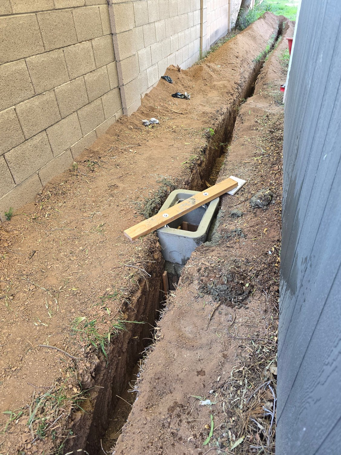

It went great! This is the exact same machine I used to cut my footings and for trenching my driveway for the drainage. I absolutely love it - its about 750cc EFI with a 36" blade - the thing cuts through practically anything. On the driveway project we hit some forearm sized tree roots and this thing chewed through in maybe 10 seconds.
My favorite feature is the "intelligent" drive system. Once you set your cut depth, you can just squeeze the speed levers to max and it'll auto adjust movement speed to keep the engine rpm above a certain level. Takes all of the thinking out of it as you just hold the levers to max and it goes as fast as it can for that depth of cut and soil conditions (which for me with this hard dirt is barely a crawl).
The downside for this specific job of course is the size since it's fairly beefy. Had to wander the line a little bit weaving around the shed, trees, etc. Straight enough I wont have to bend the straight conduit sections but it does look like I was drunk when I did it.

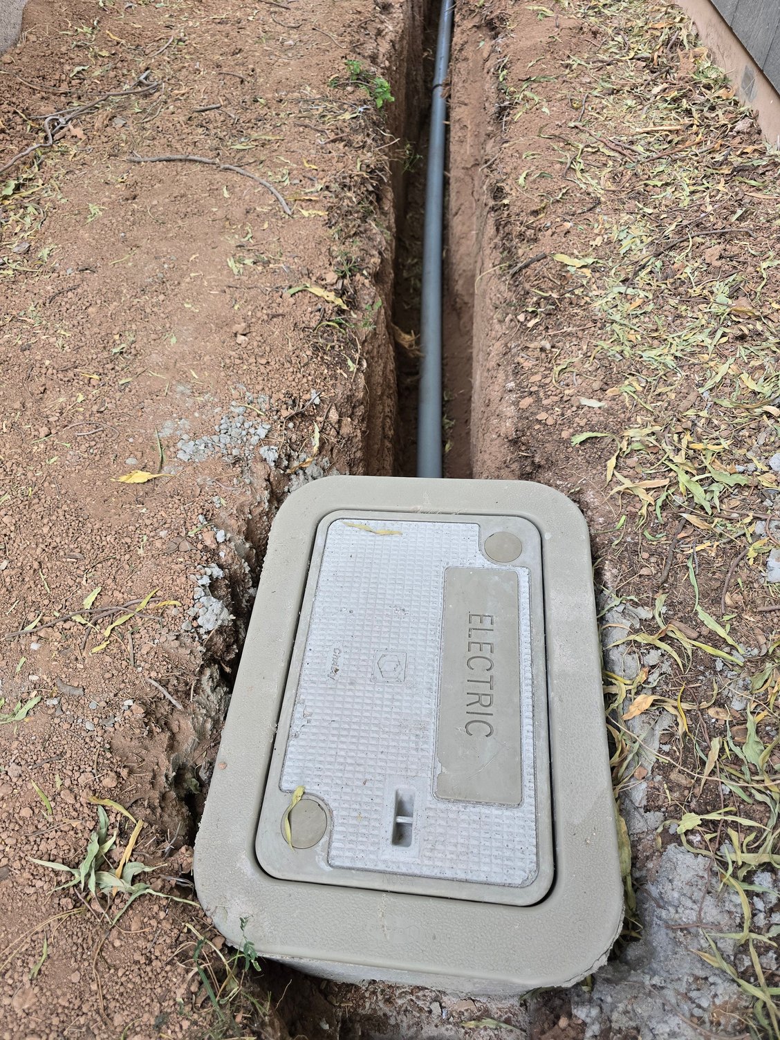

Made some more good progress on this part of the project today. I got the pull box / handhole spot dug out, formed up the concrete base, and wet set it in the concrete. Unfortunately I had to extend the height up like this to allow the garage wire to pass straight through (rather than 90* bends up into the box as youd normally see) as Im out of allowable bends in the conduit by this point.
Since it had to fall in this section of conduit, I stuck it behind the shed to hide it. As a side benefit, I did pop in a couple of pass thrus in the form to run smaller conduit to the shed later / after this garage inspection is complete. Id just like to have a basic 20 amp circuit in the shed for lights / and both an internal and external outlet.
Unfortunately itll have to run in separate conduit as Im already capped out on the fill capacity of the main stuff at the schedule 80 verticals. But at least the small stuff is a lot cheaper and Ive already got everything all opened up.
Pic inside (the big pass thrus on the lower left/right are for the garage, the smaller/ higher one on the top and right is for the shed - all of those forms and plugs will come out once the concrete sets up):
https://cimg1.ibsrv.net/gimg/monteca...94949a8f7f.jpg
