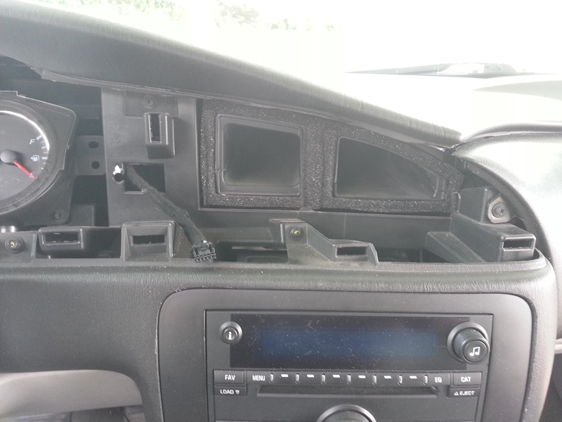

Do you know if I need to replace a fuse, because my right side info buttons aren't working. The area to check trips, fuel, etc?
Old Mar 3, 2017 | 07:43 PM
Barovelli's Avatar
Posts: 888
From: Monterey Bay Area, CA
Check the plug to the buttons first. Need to remove the plastic dash panel in one long piece (mostly snaps) to access it. See if someone had it off and forgot to plug it back in.
