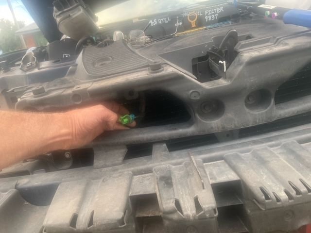

Hi,
Saw this dangling plug on the passenger side in front of the upper radiator when I had the front bumper cover off. Zip tied it for now.
No components around it to connect to...
Took a pic and thought I'd ask out of curiosity or if my car is missing something because maybe the factory wouldn't just leave it dangling like this...
Thanks

Do you have the overhead info unit? Looks like the thermometer plug on my '05.

The overhead headliner unit seems to just shows if the passenger seat air bag is on/occupied or not and if it is, if the seat belt is not being used.
Oh a thermometer, that'd be cool. hmm
