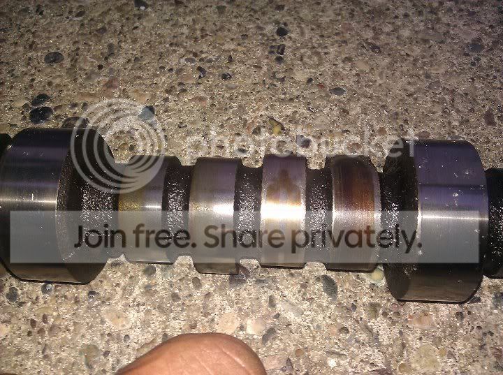

Well me and the fiance and my step son made a family affair of it and finally dug into the motor. It started with a cam swap and went to oh so much more. First we took the cam out and it was worn to crap. 3 lobes were completely rounded.

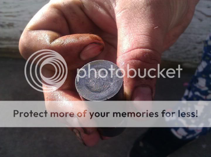

The lifters were worn BAD!

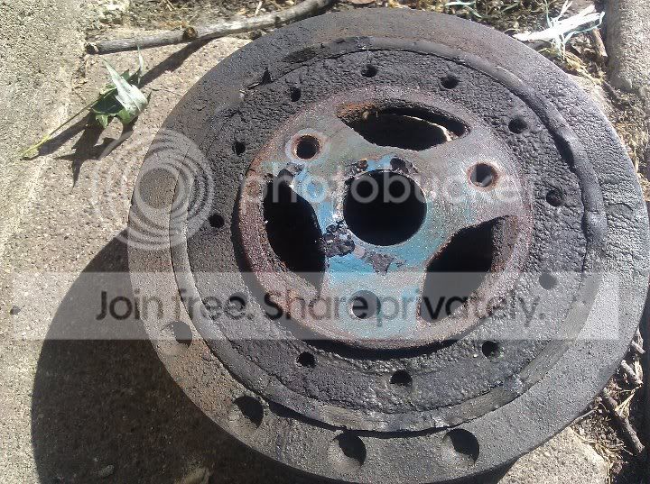

Then there was the harmonic balancer
