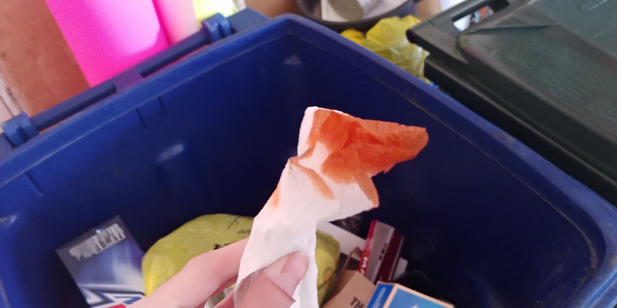

Well, I swapped out the MAF sensor, and the check engine light went away. Started it and it hasn't stalled. Popped off the little FPR tube, and I don't feel/see any fuel.
But I did find an orange/red liquid on a flat part of the engine just below the FPR. I haven't run it for a week, and the temp has gone from -30 to 25 degrees so condensation build up is possible, maybe mixing with rust, but can you (or anyone) identify it?
First is what I got when I stuck a paper towel in it, second is the location. Might be totally unrelated, just a symptom of snow/moisture buildup?
