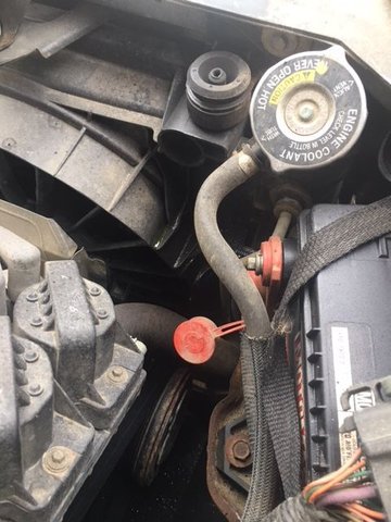

See below... to that thing next to the rad cap. And you can see it pooling very closely below (and then it goes down below/onto belts)

So does that thing next to the rad cap suppose to have a cap? or be open like it is? And should I siphon some coolant out if I put too much in? That's what might be happening? It's overflowing out of that little nozzle?
Old Nov 10, 2017 | 04:36 PM
Posts: 4,161
The thing next to the radiator cap I believe is just a bushing for the radiator mount.. Its like that on mine anyway..

So I siphoned out the excess I had in resevoir and put it right where it should be, then I dumped some warm water over everything to sorta ofrinse it.
Let the car run a bit and get hot and when I look over top of the belts I can feel slight spray/coolant flicking onto me (as well the pattern under the hood of wetness). I can't find drops or any obvious leaks and around the cap seems to be dry. The majority of the wetness is around the belts - you can see in these pics where it is getting on to.
