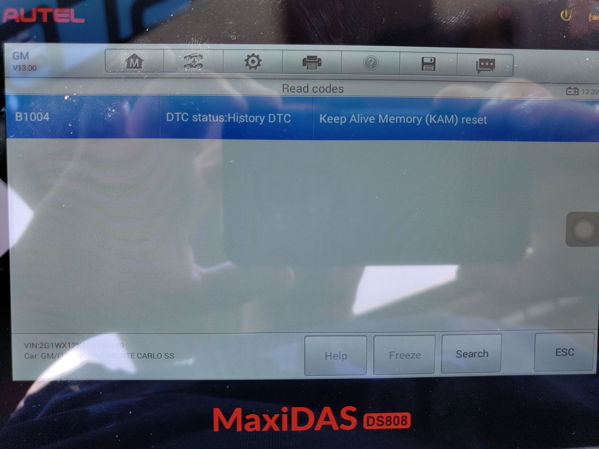

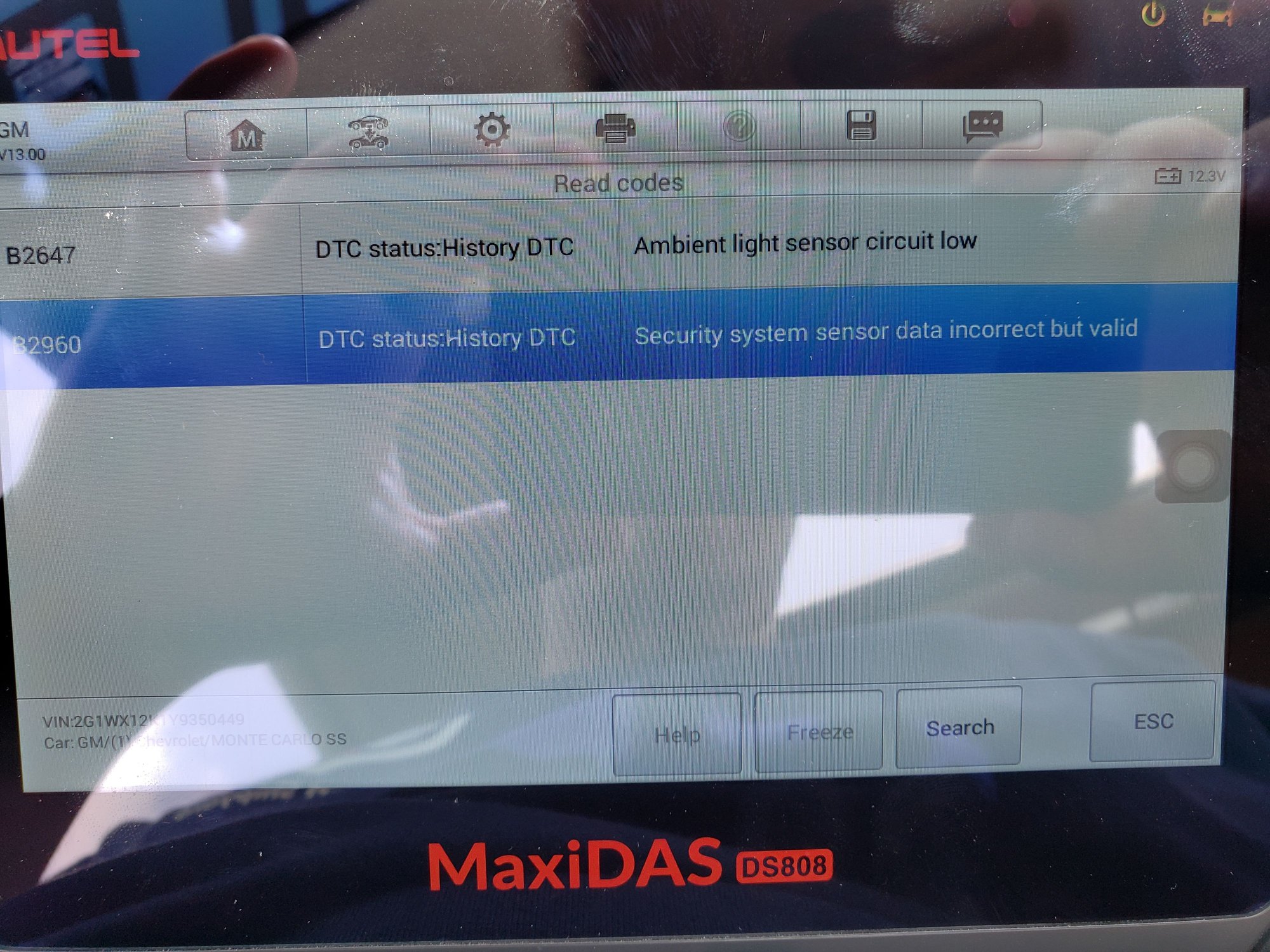

I had recently removed power from the car. Is that causing these codes or is it related to my problem? Also I got the problem to go away after repeatedly activating the TCC solenoid with a tester.
