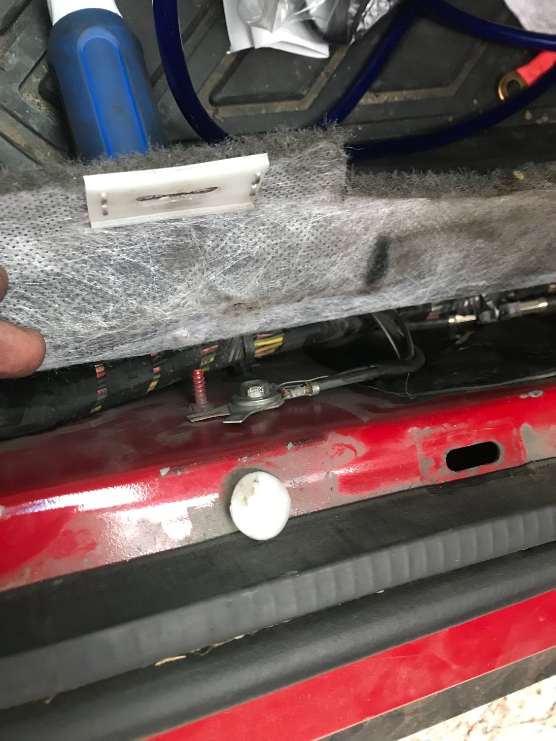

After checking power to relay and finding it good I decided chase wiring and found where the pump grounds to I also looked online to confirm that it was the correct ground. I seen it was on top a thick coat of paint so I scratched it off and bolted it back turned the key the pump kicked in nice and strong and the car started without hesitation. The location of the ground is underneath the plastic trim beside the front of the passenger seat in case anyone else has this issue.
