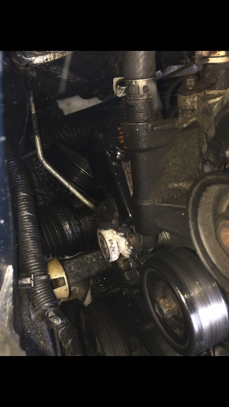

Over the weekend I was driving and hear a noise something that sound like something had broke or came loose. So I pulled over(battery light comes on as I’m slowing down). I pop the hood and I see smoke and see the S belt has come off. I inspect it and it seems fine. So I decide to simply put it back on so I can atleast get it to a shop and off the side of the country road. That’s when I see the power steering pulley is missing!i eventually find it sitting behind the motor. So I replace the pump and pulley on the side of the road. Next day I drive with in a hour of driving(highway driving) the same thing happens again! Once again the belt is off and the pulley has broken. Anyone have a clue as to what’s causing this?

Very odd that 2 pulley's broke in that little time. When you replaced the pump did it already have the pulley on it or did you put it on ? Wouldn't think it was a alignment issue considering it only has 3 bolt's that go thru the pulley. Kinda hard to tell from picture but ,was it a new or used replacement pump ? And as Driver#3 suggested check the tensioner .

It was a brand new pump and pulley. The pulley was pressed on to the pump. If the tension was the issue wouldn’t it be affecting other pulleys? Also if the alignment was off wouldn’t it damage the actual belt before the pulley? The pump and pulley is under warranty but scared to replace it again without figuring out the cause.

Also the pulley itself wasn’t damaged! What caused it to come off was the bolt/shaft that comes attached to the pump broke off. The bolt/shaft that the pulley is pressed onto that’s what broke causing the pulley to come off. That’s what cause me to replace the first pump. Again the pulley itself wasn’t damaged it was the shaft that snapped off
