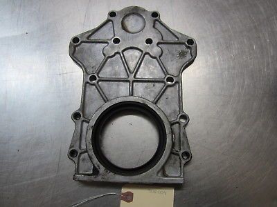

Got the Monte back yesterday after a week in the shop. The mechanic pulled the engine and upon inspection found the rear seal housing was cracked, so replaced that, the seal and all the gaskets. So hopefully that solved it! I had never heard about problems with the rear seal housing but was able to find a photo of it online in case anyone is curious of what it looks like.
